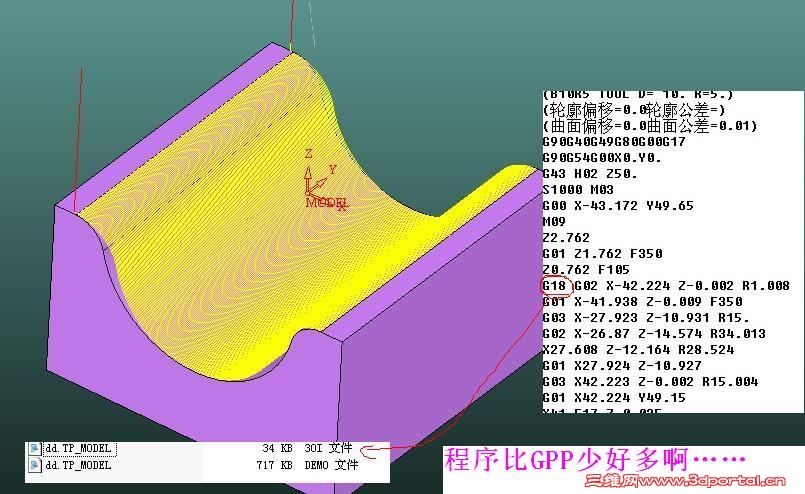

发表于 2011-8-11 00:00:39 | 显示全部楼层 来自: 中国重庆
IF (ARC_PLN == 2); k4 a, T" C& D/ h' R
                SET_ON X_CURPOS Z_CURPOS X_CENTER Z_CENTER RADIUS_ ;                 IF_SET (X_CURPOS) OUTPUT SPACE "X" X_CURPOS ; END_IF ;                  IF_SET (Z_CURPOS) OUTPUT SPACE "Z" Z_CURPOS ; END_IF ;                                                  IF_SET (X_CENTER) OUTPUT SPACE "I" X_CENTER ; END_IF ;                  IF_SET (Z_CENTER) OUTPUT SPACE "K" Z_CENTER ; END_IF ; 给点提示你

输出XZ与YZ平面拟合圆弧可以输出,问题是G17G18G19的模态如何同G01G02G03区别开,这个搞死我,
8 H4 q0 M4 I' a( g1 _请WUCHUANFU88支持一下) D% a2 }9 T9 H3 E0 B
G18" k5 _. n% s4 D+ ], w
G02 X12.786 Z9.594 I12.661 K4.888
7 _+ p- t! }+ |/ q9 H9 oG01 Y-18.85
& W. P6 C, j6 t- U5 }X12.66 Z9.256 - U! k; @# Z6 @
G183 B+ i  A& k# h7 p. S/ d
G03 X-12.786 Z9.596 I-12.66 K4.889 # O& W7 {3 v( K$ U* l
G01 Y-19.35 & u( a0 }! l; J- w1 v( _
X-12.661 Z9.257
' x, F) d9 |# S7 V" O  ?G18/ p: w; C5 }5 \! G0 ]
G02 X12.786 Z9.594 I12.661 K4.888 7 k2 O+ W. j- J. q6 O
G01 Y-19.85 9 M$ C$ L$ O1 R! L" Q
X12.66 Z9.256
) A' g; P  v$ @/ }  D* QG18: f1 @( P$ h9 W! k) Q5 L7 K/ p
1 G1 ]: N  i1 L$ EG01 X-12.92 Z10.011 F105.
4 \( ^4 H. t4 K# Z2 u3 r! sG18- b! o! `& w; _
G03 X-10.988 Z15.412 I4.827 K1.319 ! `4 ~) h  ^9 k9 v" F
G00 Z63.9772 |8 o7 C( r2 M# a! B6 p
G00 X19.65 Y-4.75 , d$ G' m, }; {) u/ N  V
Z15.136
3 ?+ |7 k/ _* q# A4 jG01 Z14.136 F105.
: d  Z- ^. B, ?# eZ13.136
- W9 |3 N2 |) E! \2 S+ ?8 F( L2 jG19
2 `) w; _9 w7 j' [% O- t& K* j* ~8 OG03 Y-7.96 Z7.964 J1.767 K-4.679 / W* M5 h6 x7 G0 h' J6 E3 _- n
G01 Y-7.939 Z7.749 F350.
9 f+ J" d3 V. d, ^  E) rG19
" C, G( y* @4 [0 t" b/ vG03 Y7.965 Z8.014 J7.938 K0.96
- k9 }# I! `5 O* i: c& Y" BG01 X19.15 4 |) _8 V  a( L# w  O, p) G/ m3 C- q, h
Y7.944 Z7.789
" K/ a" u3 C! q: q; C9 M  n' gG19
* q: Y$ V* [. B" r3 t; s0 vG02 Y-7.96 Z7.964 J-7.943 K0.92
! Y9 V6 l5 L! ]" U6 F6 \G01 X18.65 4 b0 Q  t2 Y+ L1 h6 k6 V6 N) J
Y-7.939 Z7.749
  w* v4 J9 m# E! s& E' lG19. N2 @2 T4 ?; @2 }  {  U
G03 Y7.965 Z8.014 J7.938 K0.96 : H! k' }8 ~9 A0 I
G01 X18.15 6 F; G' I0 r/ V9 Y5 J, U) L
Y7.944 Z7.789

我也改了,不过好像有问题啊,这样的程式赶上机吗???) W) r5 c/ F+ r6 F4 i
G01 Z1.762 F350.
/ A2 a$ t- ^! R* ?8 P. B1 QZ0.762 F105.: k, u" r8 e- j& M) |6 p% ^( r8 E! q
G18G02 X-42.224 Z-0.002 I-0.978 J0.0 " g* R/ p: I, P& }
G01 X-41.938 Z-0.009 F350.
  ^1 R" h3 G# ]7 S: N1 s1 PG03 X-27.923 Z-10.931 I0.422 J0.0
7 w& a' ^4 a4 ?. [3 K8 ZG02 X27.924 Z-10.927 I-27.923 J0.0
1 a  F* Z5 S- p0 oG03 X42.223 Z-0.002 I-14.44 J0.0
4 [" ^# ^) |7 ^+ S" G0 tG01 X42.224 Y49.15
. C  M( L; e3 t# _- W+ \1 t0 bX41.517 Z-0.025
  H% M. l" a+ \" a$ g: ]; v+ JG02 X27.924 Z-10.927 I-0.848 J0.0
( s5 m+ p9 x& P" ~- H- N  WG03 X-27.923 Z-10.931 I27.924 J0.0
( ]2 e( h! c; D8 a( e4 pG02 X-42.224 Z-0.002 I14.441 J0.0 & _; r0 z: J9 z( V+ |5 ]% O, ?
G01 Y48.65
2 Z. P; l9 ~5 LX-41.938 Z-0.009
4 F" E/ E% q1 r3 aG03 X-27.923 Z-10.931 I0.422 J0.0
) e5 n2 f  P' q& y8 O% o' IG02 X27.924 Z-10.927 I-27.923 J0.0
7 Q3 \% i( N& A, AG03 X42.225 Z-0.002 I-14.44 J0.0 % e2 c0 p+ U9 [8 E& j
G01 Y48.15 8 x- j* K3 _' J7 o8 y* v
X41.517 Z-0.025
, A1 N7 o3 m1 }3 H, Z5 |" }8 [+ Q2 y8 XG02 X27.924 Z-10.927 I-0.848 J0.0
$ ?! d% A0 Y6 A) f  WG03 X-27.923 Z-10.931 I27.924 J0.0 . W- F/ O5 c! P' D) _% P2 K4 F
G02 X-42.224 Z-0.002 I14.441 J0.0 " d- b# c+ ?' u; d3 p$ h$ R5 c
G01 Y47.65
# i: a! i1 Q/ W) ^! m: Y4 tX-41.938 Z-0.009 # J% @0 l0 M6 K, z5 ]
( K4 j0 G. a' `( m/ c5 K% WG02 X27.924 Z-10.927 I-27.923 J0.0
6 v4 Q- A3 ~& ?, ], I' [6 x" q" }G03 X42.225 Z-0.002 I-14.44 J0.0
) H3 t) q# g% u1 TG01 Y47.15
- H* K  p0 L; V4 K# i" XX41.517 Z-0.025 0 G( R+ M: S& q5 W
# q; ]  m% H, k) k/ S3 g( N/ ]G03 X-27.923 Z-10.931 I27.924 J0.0
/ Q- Y& C8 ]' B+ J1 Q! fG02 X-42.224 Z-0.002 I14.441 J0.0 2 g; L; S! ^# Q1 v, Z" \- Z+ g& `
G01 Y46.65
6 X# i: E* K2 FX-41.938 Z-0.009
3 A$ U7 j& b& I1 r2 c. ^G03 X-27.923 Z-10.931 I0.422 J0.0 ! g3 ^- z% t% k9 m: K5 I( {
G02 X27.924 Z-10.927 I-27.923 J0.0 ! C; l: e3 M) J
G03 X42.225 Z-0.002 I-14.44 J0.0 9 O6 d+ V6 x/ u' |
G01 Y46.15
* g# ~  }3 I( \- _X41.517 Z-0.025
! ^; a5 _& @0 g- s' [. ^& S# RG02 X27.924 Z-10.927 I-0.848 J0.0
( b/ u" t) c( ?# I: {$ FG03 X-27.923 Z-10.931 I27.924 J0.0
2 U$ O% a. l# _2 \5 a+ c5 U; MG02 X-42.224 Z-0.002 I14.441 J0.0 + Z  D/ A) x& X" G4 e' ?$ \
G01 Y45.65
5 ?5 }7 J+ n! u) nX-41.938 Z-0.009
# M( p3 |2 E1 f" w2 vG03 X-27.923 Z-10.931 I0.422 J0.0 6 x* {  p" e! V9 @% ^  N
G02 X27.924 Z-10.927 I-27.923 J0.0 # T5 ]* V# W7 n- K
G03 X42.225 Z-0.002 I-14.44 J0.0 4 n' _8 Z4 ^1 @1 f: N' n
G01 Y45.15
! Y9 V( M6 u- @- P0 u0 AX41.517 Z-0.025
+ u) q2 ~6 c1 t' q) ^5 O: r: ~G02 X27.924 Z-10.927 I-0.848 J0.0

% N7 J! J0 p$ r; K# \, J$ ?你这个是错的,看看这句
: r% G8 Z5 n6 ^6 J- J& \G18G02 X-42.224 Z-0.002 I-0.978 J0.0 ! J% d+ u3 D$ f! b3 u
在G18的情况下是不可以输出“J”的,
