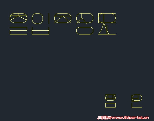

·¢±íÓÚ 2012-1-18 11:38:56 | ÏÔʾȫ²¿Â¥²ã À´×Ô£º ÖйúºÓ±±ÌÆÉ½
ºÇºÇ£¬°ÑHSG×ÖÌå¼ÓÈë×Ö¿âºóÊÇÕâ¸öЧ¹û£¬Äã¿´ÊÇÄãÏëÒªµÄô£¿

 Â¥Ö÷| ·¢±íÓÚ 2012-1-18 12:25:05 | ÏÔʾȫ²¿Â¥²ã À´×Ô£º Öйú±±¾©
ÕâÖÖЧ¹ûÎÒÒѾ­Åª³öÀ´ÁË£¬ÏÔʾµÄ²¢²»ÊǺ«ÎÄ£¬»¹Ï൱ÓÚÂÒÂ룬ÎÒÏëÒªµÄÊÇÏÔʾº«ÎÄ£¬Ö÷ÒªµÄÄ¿µÄÊÇÏë·­ÒëÎÄ×ÖµÄÄÚÈÝ¡£
