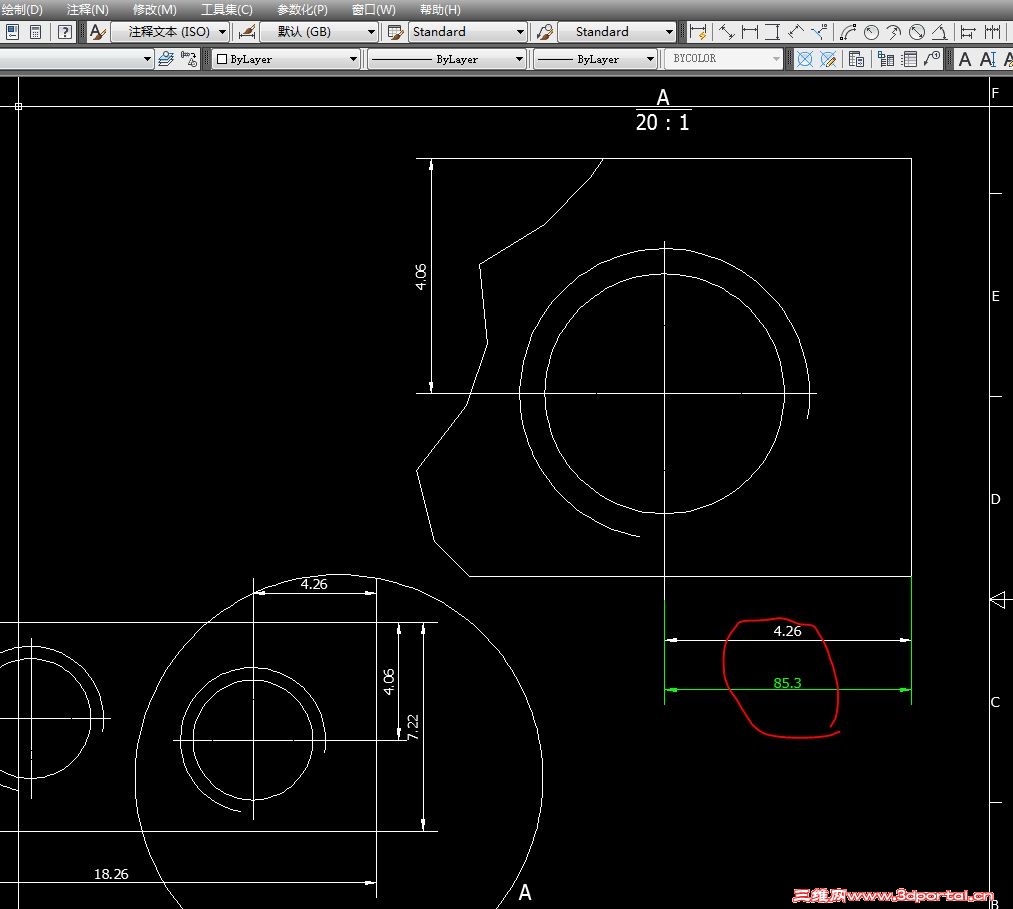

- [5 g1 |2 {) ?) G* @ǵDXFͲDZעͲ11. z5 I& e! I, k* V
3 F0 M: m4 v- o  K% |/ ?" \$ V9 [ôŪǺϣ

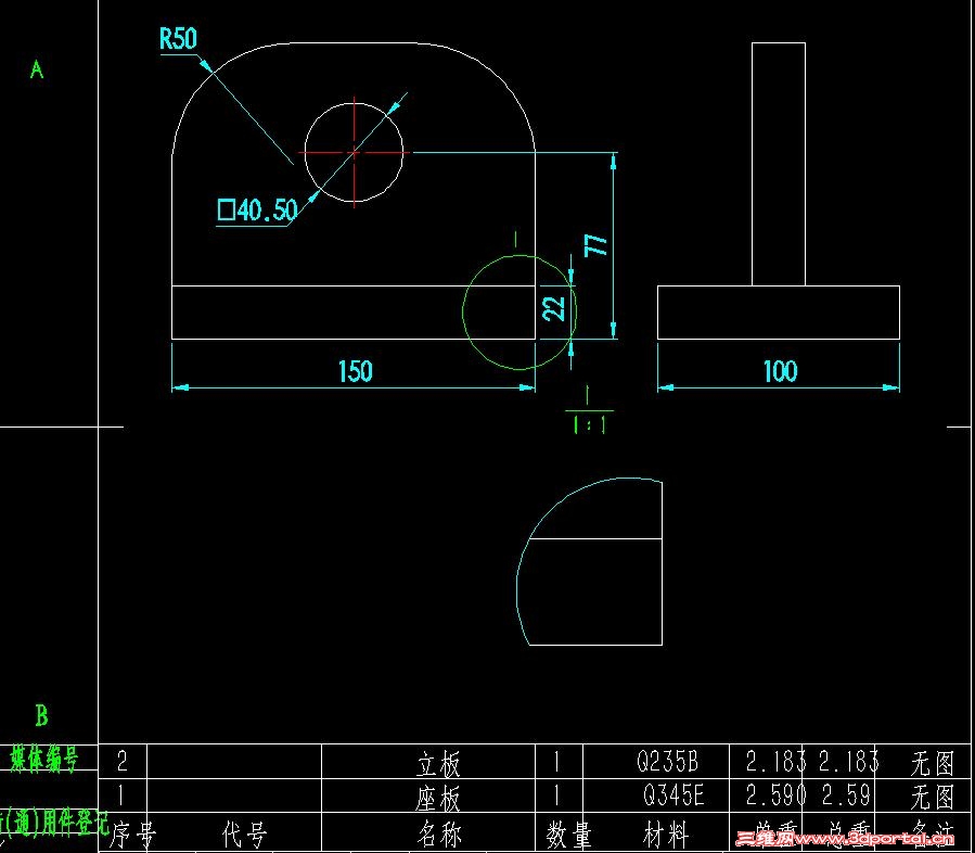

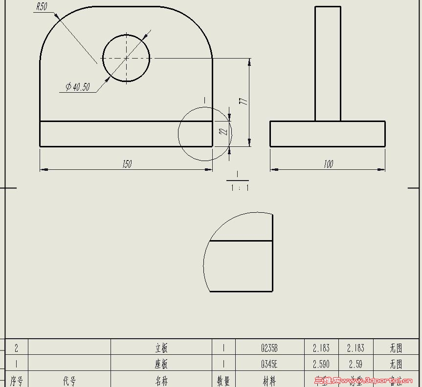

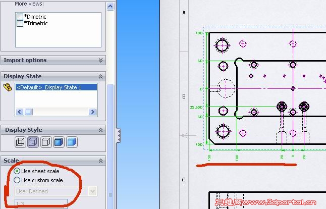

# O2 B1 k6 u8 n2 jһȥSWתΪDXFֲDzɱģҶ֪ġ˵ĿǺϣǷṩ+ x5 I' U6 w( S5 _# F' I1 s$ r# w
( g7 e$ w, ?4 `
⣬̳ҲйۡҲûпһõĽ# Z. `  }0 j, g- ?! r/ s; A) ]
' S/ X5 E0 B4 h# e  ^* ~! ^& p8 m% O4 [8 {* t+ R1 h
* W: f+ H+ {! K; Y- q4 v& n& u( y SW.JPG   Y: |! |9 M. D! s. q. P: \
# t) j; v# D7 y5 t3 s/ v
InvҪCADǺϵġ" ^( Q! Q" L3 U
6 d. I+ N, X' _
- Z8 `: g- g0 k0 ^( m4 O Inv.JPG

һҲܳͼͻûSWֻöתΪDXFͼֽ11תֲͼıɱ' P0 h7 j, j7 _$ a& ?0 y
- x% C9 O2 S" G3 B8 R˵⣬ạָ̃лл
2012-2-28 14:04:31 | ʾȫ¥ ԣ ձ
13# linux1234 ; E  V" F/ M: Y  i% {5 `6 P
5 v% e% b+ `6 t1 Q
+ Y3 W- A, Q3 J1:1ûͼа
; X+ x$ X+ J) Z5 M- j4 n- U; D& {* C
1 {1 G7 V% w0 x+ X; i3 v) k4 ?4 a/ o/ c& o2 V
.JPG

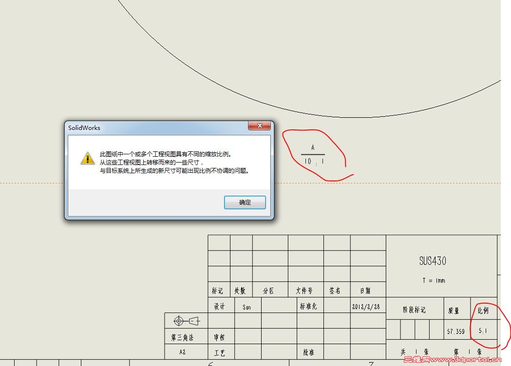

2012-2-28 16:27:22 | ʾȫ¥ ԣ ձ
hongwei_1987jp 2012-2-28 16:33 ༭
: n, q$ s" @1 f  _# C& S" n. R$ r8 |( f) Z$ }' ~
22# hhyjs
8 e' I$ b; D, H8 H4 v* S' @4 T3 x- T1 J! T0 a" J: Z2 T: z

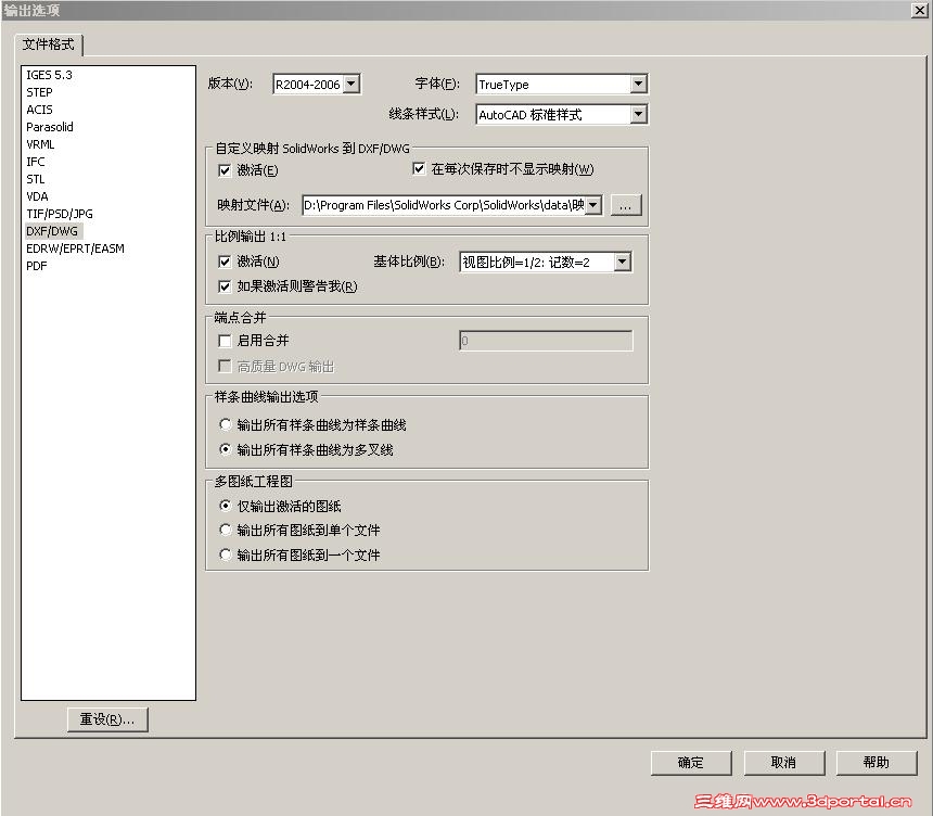

4 v$ r7 O4 _* |, n֪ģCAD±עһ¿עֲͼıߴǷͼɱ; Y1 v6 i7 e# c" A* s" E+ M4 N
! [  E2 g  j4 Y% ^& q6 R
0 x! J* ?5 Z- z& ~9 iҵ˼˵SWעͼijߴ*ͼֽıͼһ*
2012-2-28 16:36:37 | ʾȫ¥ ԣ ձ
18# ɧϿ˿
/ h+ a2 s2 P2 z2 L5 B% n! D: h( u5 p% N' O6 e
64λ
* B; C1 y5 Z8 l  z9 I% r; ], W' M/ U( R# }+ p* {+ ?& |' \4 Z
.JPG
