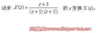

8 V2 E% K- B$ [' M5 e试求X(s) =s+3/(s+1)(s+2) 的z 变换X (z)
