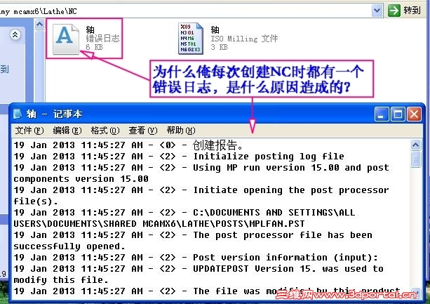

[已解决] NC错误日志
发表于 2013-1-19 13:49:11 | 显示全部楼层 |阅读模式 来自: 中国江苏无锡

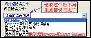

发表于 2013-1-19 16:28:22 | 显示全部楼层 来自: 中国广东东莞
把日记完整内容放上来看看.可以你更新的后处理有小小错误 .或进入机床设置把生成错误消息改改方式.
路过不买 + 2 应助
发表于 2013-1-19 21:08:26 | 显示全部楼层 来自: 中国上海
如果后处理时没有提示错误,你可以在控制器里面改掉后处理错误的输出类型。
 楼主| 发表于 2013-1-20 09:35:04 | 显示全部楼层 来自: 中国江苏无锡
yuanmeto 发表于 2013-1-19 16:28 static/image/common/back.gif
. I# p  e" I& |' y. k- C把日记完整内容放上来看看.可以你更新的后处理有小小错误 .或进入机床设置把生成错误消息改改方式.
8 {; y8 ^5 \; D+ y+ {3 D
19 Jan 2013 11:45:27 AM - <0> - 创建报告。
19 Jan 2013 11:45:27 AM - <2> - Initialize posting log file
19 Jan 2013 11:45:27 AM - <2> - Using MP run version 15.00 and post components version 15.00
19 Jan 2013 11:45:27 AM - <2> - Initiate opening the post processor file(s).
19 Jan 2013 11:45:27 AM - <2> - C:\DOCUMENTS AND SETTINGS\ALL USERS\DOCUMENTS\SHARED MCAMX6\LATHE\POSTS\MPLFAN.PST
19 Jan 2013 11:45:27 AM - <2> - The post processor file has been successfully opened.
19 Jan 2013 11:45:27 AM - <2> - Post version information (input):
19 Jan 2013 11:45:27 AM - <2> - UPDATEPOST Version 15. was used to modify this file.
19 Jan 2013 11:45:27 AM - <2> - The file was modified by this product on 20 May 11 21:59:05
19 Jan 2013 11:45:27 AM - <2> - The post was written to run with Mastercam Version 15.
19 Jan 2013 11:45:27 AM - <2> - The post product type is 铣床/车床.
19 Jan 2013 11:45:27 AM - <2> - Initialization of pre-defined post variables, strings, postblocks was successful.
19 Jan 2013 11:45:27 AM - <2> - Search for defined post variables, strings, postblocks was successful.
19 Jan 2013 11:45:28 AM - <2> - CONTROL DEFINITION - Post variable 'ltol$' was re-initialized from 0.0005 to 0.002
19 Jan 2013 11:45:28 AM - <2> - CONTROL DEFINITION - Post variable 'atol$' was re-initialized from 0.5 to 0.01
19 Jan 2013 11:45:28 AM - <2> - CONTROL DEFINITION - Post variable 'err_file$' was re-initialized from 0. to 1.
19 Jan 2013 11:45:28 AM - <2> - CONTROL DEFINITION - Post variable 'dec_seq_left$' was re-initialized from 3. to 4.
19 Jan 2013 11:45:28 AM - <2> - CONTROL DEFINITION - Post variable 'omitseq$' was re-initialized from 0. to 1.
19 Jan 2013 11:45:28 AM - <2> - CONTROL DEFINITION - Post variable 'sub_seq_typ$' was re-initialized from 0. to 1.
19 Jan 2013 11:45:28 AM - <2> - CONTROL DEFINITION - Post variable 'nobrk$' was re-initialized from 1. to 0.
19 Jan 2013 11:45:28 AM - <2> - CONTROL DEFINITION - Post variable 'nobrkxz$' was re-initialized from 1. to 0.
19 Jan 2013 11:45:28 AM - <2> - CONTROL DEFINITION - Post variable 'nobrkyz$' was re-initialized from 1. to 0.
19 Jan 2013 11:45:28 AM - <2> - CONTROL DEFINITION - Post variable 'lnobrk$' was re-initialized from 1. to 0.
19 Jan 2013 11:45:28 AM - <2> - CONTROL DEFINITION - Post variable 'lnobrkxz$' was re-initialized from 1. to 0.
19 Jan 2013 11:45:28 AM - <2> - CONTROL DEFINITION - Post variable 'lnobrkyz$' was re-initialized from 1. to 0.
19 Jan 2013 11:45:28 AM - <2> - CONTROL DEFINITION - Post variable 'arcoutput$' was re-initialized from 1. to 0.
19 Jan 2013 11:45:28 AM - <2> - CONTROL DEFINITION - Post variable 'arcoutputxz$' was re-initialized from 1. to 0.
19 Jan 2013 11:45:28 AM - <2> - CONTROL DEFINITION - Post variable 'arcoutputyz$' was re-initialized from 1. to 0.
19 Jan 2013 11:45:28 AM - <2> - CONTROL DEFINITION - Post variable 'larctype$' was re-initialized from 2. to 5.
19 Jan 2013 11:45:28 AM - <2> - CONTROL DEFINITION - Post variable 'larctypexz$' was re-initialized from 2. to 5.
19 Jan 2013 11:45:28 AM - <2> - CONTROL DEFINITION - Post variable 'larctypeyz$' was re-initialized from 2. to 5.
19 Jan 2013 11:45:28 AM - <2> - CONTROL DEFINITION - Post variable 'breakarcs$' was re-initialized from 0. to 1.
19 Jan 2013 11:45:28 AM - <2> - CONTROL DEFINITION - Post variable 'breakarcsxz$' was re-initialized from 0. to 1.
19 Jan 2013 11:45:28 AM - <2> - CONTROL DEFINITION - Post variable 'breakarcsyz$' was re-initialized from 0. to 1.
19 Jan 2013 11:45:28 AM - <2> - CONTROL DEFINITION - Post variable 'lbreakarcs$' was re-initialized from 0. to 1.
19 Jan 2013 11:45:28 AM - <2> - CONTROL DEFINITION - Post variable 'lbreakarcsxz$' was re-initialized from 0. to 1.
19 Jan 2013 11:45:28 AM - <2> - CONTROL DEFINITION - Post variable 'lbreakarcsyz$' was re-initialized from 0. to 1.
19 Jan 2013 11:45:28 AM - <2> - CONTROL DEFINITION - Post variable 'helix_arc$' was re-initialized from 1. to 0.
19 Jan 2013 11:45:28 AM - <2> - CONTROL DEFINITION - Post variable 'lhelix_arc$' was re-initialized from 1. to 0.
19 Jan 2013 11:45:28 AM - <2> - CONTROL DEFINITION - Post variable 'do_full_arc$' was re-initialized from 1. to 0.
19 Jan 2013 11:45:28 AM - <2> - CONTROL DEFINITION - Post variable 'do_full_arcxz$' was re-initialized from 1. to 0.
19 Jan 2013 11:45:28 AM - <2> - CONTROL DEFINITION - Post variable 'do_full_arcyz$' was re-initialized from 1. to 0.
19 Jan 2013 11:45:28 AM - <2> - CONTROL DEFINITION - Post variable 'ldo_full_arc$' was re-initialized from 1. to 0.
19 Jan 2013 11:45:28 AM - <2> - CONTROL DEFINITION - Post variable 'ldo_full_arcxz$' was re-initialized from 1. to 0.
19 Jan 2013 11:45:28 AM - <2> - CONTROL DEFINITION - Post variable 'ldo_full_arcyz$' was re-initialized from 1. to 0.
19 Jan 2013 11:45:28 AM - <2> - CONTROL DEFINITION - Post variable 'rotfeed4$' was re-initialized from 2. to 1.
19 Jan 2013 11:45:28 AM - <2> - CONTROL DEFINITION - Post variable 'rotfeed5$' was re-initialized from 3. to 1.
19 Jan 2013 11:45:28 AM - <2> - CONTROL DEFINITION - Post variable 'lrotfeed4$' was re-initialized from 2. to 1.
19 Jan 2013 11:45:28 AM - <2> - CONTROL DEFINITION - Post variable 'lrotfeed5$' was re-initialized from 0. to 1.
19 Jan 2013 11:45:28 AM - <2> - CONTROL DEFINITION - Post variable 'sub_level$' was re-initialized from 0. to 0.
19 Jan 2013 11:45:28 AM - <2> - CONTROL DEFINITION - Post variable 'lusecandrill$' was re-initialized from 1. to 0.
19 Jan 2013 11:45:28 AM - <2> - CONTROL DEFINITION - Post variable 'lusecanpeck$' was re-initialized from 1. to 0.
19 Jan 2013 11:45:28 AM - <2> - CONTROL DEFINITION - Post variable 'lusecanbore1$' was re-initialized from 1. to 0.
19 Jan 2013 11:45:28 AM - <2> - CONTROL DEFINITION - Post variable 'lusecanbore2$' was re-initialized from 1. to 0.
19 Jan 2013 11:45:28 AM - <2> - CONTROL DEFINITION - Post variable 'lusecanmisc1$' was re-initialized from 1. to 0.
19 Jan 2013 11:45:28 AM - <2> - CONTROL DEFINITION - Post variable 'lusecanmisc2$' was re-initialized from 1. to 0.
19 Jan 2013 11:45:28 AM - <2> - Successful completion of posting process!

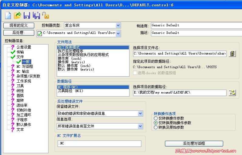

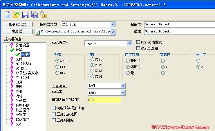

 楼主| 发表于 2013-1-20 09:58:33 | 显示全部楼层 来自: 中国江苏无锡
路过不买 发表于 2013-1-19 21:08 static/image/common/back.gif) [# F8 A& f# {  k- {) o
* A, h5 ]. P- Z/ u- b: t9 @0 ^2 P4 p 传输.JPG % j1 H6 T! z$ }) I
刀具路径.JPG 9 E+ W, O" P* G! Y; n; K: ]) s
启动与退出.JPG 9 V8 O; ?3 X0 r; ^- D* w0 J
俺使用的都是默认选项,请老大看一下问题出在那里。' G: u8 u/ \% @6 a* c
还有请教下面一个问题:
: `& a( u8 A! L MASTERCAM编辑器.jpg
6 Q* N9 H" x# Q4 K- U
& w5 J; |1 H# r7 r) C' i
发表于 2013-1-20 19:10:08 | 显示全部楼层 来自: 中国福建莆田
看你的后处理信息,没看到后处理有什么问题,你可以在第二张图片上把保留错误文件里面的设置一下就可以了
发表于 2013-1-20 20:12:53 | 显示全部楼层 来自: 中国上海
你的后处理没啥错误,在那个后处理错误文件里面,将后处理错误保存类型 改为致命错误就可以了~
 楼主| 发表于 2013-1-22 17:46:48 | 显示全部楼层 来自: 中国江苏无锡
感谢楼上几位,按你们的指教方法解决了问题。
