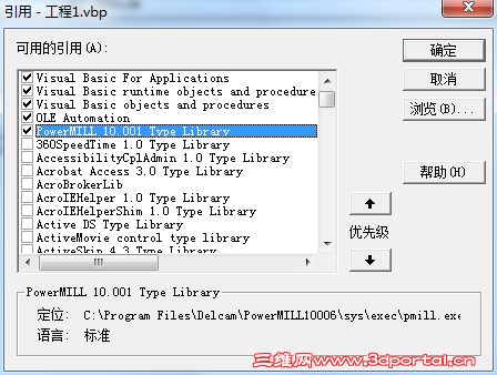

Dim PM  As PowerMILL.Application# f1 f6 i4 i- Q3 q
Set PM = CreateObject("PowerMILL.Application")- r0 b, z$ f! f: e) `/ ?' t
PM.Visible = True$ [2 `( H7 s+ [; N  z8 m0 k$ J. r4 o
PM.DoCommand "CREATE TOOL" & " D10" & " ENDMILL". M$ G0 D3 K+ |; G
PM.DoCommand "EDIT TOOL" & " D10" & " DIAMETER" & " 10"
1 V* I6 ?! g  b" a PM.DoCommand "MACRO " & App.Path & "\体积.mac"
' l( _9 g1 H) Y' D/ ?; M( B Dim ZMIN, ZMAX As Double: k- l# c2 N- |2 ~& n& B/ E/ D' j
    ZMAX = PM.DoCommandEx("PRINT FORMVALUE RoughBlock.LimitFrame.MaxZ")2 t9 }! q$ S4 S7 H" g2 }
    ZMIN = PM.DoCommandEx("PRINT FORMVALUE RoughBlock.LimitFrame.MinZ")
- z) E% R- g- ?5 K    Text1.Text = ZMAX# e! }7 Z4 C/ K
    Text2.Text = ZMIN
: a! d/ h) {2 w7 u1 r这个PM.DoCommandEx地方出现错误"参数不可选"
引用了PM10.0
引用了PM10.0

求助VB6.0引用PM对象时获取返回的参数是不是用PM.DoCommandEx,或是谁有基它版本的PM试一下

用法是对里,我申明的对像里面有3个命令,另外两个都可以用,就是这个不行
