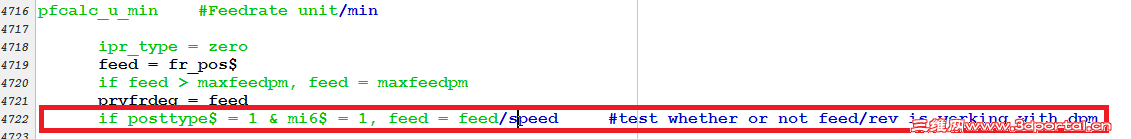

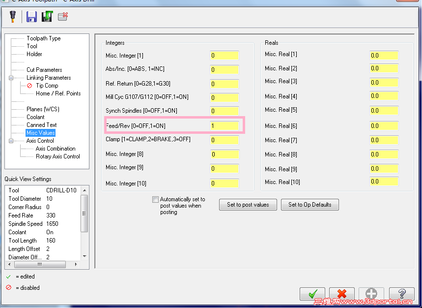

后处理升级后选择mi6=1每分进给报警
& A5 S, Z8 |! g0 [' n! K
mi6=1
mi6=1
post
post
