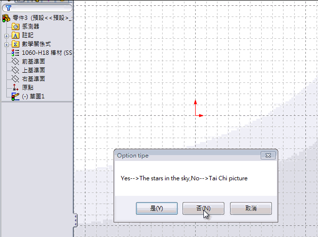

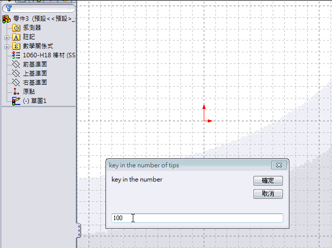

7 Y' s  M9 _. c) B" J學VBA宏的基本教材
4 F0 M. a; ]$ |1 M' R' ******************************************************************************2 [3 E5 t  H4 \* v( r
' macro recorded on 05/26/13 by scliang) C3 C& V6 s: k
'+ g) {( B; t4 E: v  A
' 操作說明& P0 j& N6 H- I. \# `
'2 y0 x9 m. }7 t8 s- l
' 1. 開SW檔,選前基準面(右或上皆可),進入草圖編輯,執行本程式.
! Z: b6 y+ q2 c5 B# g, h' {' 2. 在 Option tips 對話表按 "Yes" 鍵,作"滿天星",在 X座標-50,Y座標-50到X座標50,Y座標50 ,之範圍內隨機作畫鍵入數量的 "點".2 F5 W$ d! C' T9 X8 N3 R$ j
' 3. 在 Option tips 對話表按 "No" 鍵,作畫太極圖.# g3 i" C9 f0 x3 [6 y9 e
'( d. T: G$ t! K& T+ i1 w0 b
: t# F+ M, X9 i  ], x# _+ VDim swApp As Object
7 {: y; r* V9 [
' Y+ m5 C0 ?- }1 _0 J* J7 SDim Part As Object2 {6 }8 e, b5 q8 M" y
Dim boolstatus As Boolean
) g9 R, D( [, D9 GDim longstatus As Long, longwarnings As Long$ g" {# Z- I% l6 q8 _2 H
Sub main()
& X% |) |1 A7 ^; X1 I    Set swApp = Application.SldWorks
& Q; W  j( @7 p! o2 ?    Set Part = swApp.ActiveDoc# R' ~) i: @1 i7 r
    Dim skPoint As Object
0 J2 K5 [# Q8 P8 F9 u3 l8 d# ypi = 3.141592654" R3 D, K" r; X/ g1 K" T
continue:
) G( f/ _/ w1 s; [5 e. S3 C/ `  boolstatus = Part.Extension.SketchBoxSelect("-0.06", "-0.06", "0.000000", "0.06", "0.06", "0.000000") '
- y( F1 C4 m7 J% b6 k* ?  Part.EditDelete7 S. |, F! Q# T5 _: h9 ?* l9 v( j
  c = MsgBox("Yes-->The stars in the sky,No-->Tai Chi picture", vbYesNoCancel, "Option tipe") '選擇"滿天星"或是"太極圖"
. T# Q  J- E  J0 ?  Select Case c
% Z0 W) I  v. v6 n/ K  Case 6
: s6 i3 R  G2 i/ A9 w    point_number = InputBox("Key in the number", "Key in the number of tips", 100) '鍵入作圖點的數量
: A- o  T  U# V1 O* @! H# L    For i = 1 To point_number
$ f  ^6 Z, ~2 J7 l. _  w        X = Int((Rnd() * 50 + 1) - (Rnd() * 50 + 1)) / 1000
' {' b$ a. z6 w% b, j- |        Y = Int((Rnd() * 50 + 1) - (Rnd() * 50 + 1)) / 1000* ^/ f7 \9 Z  @9 k' b/ z
        Set skPoint = Part.SketchManager.CreatePoint(X, Y, 0#) '點作圖! ]1 a# _% ^% p: z: y  `: f
    Next
! x5 X% ^8 c" A  Case 76 O! B( l( E  S) D$ R
    For j = 0 To 360 Step 2" ^; D1 M7 ^8 I6 r" i+ e
        X = (j / 6 - 30) / 1000
% l! V* }* E2 B/ G- n; s6 a        Y = 12 * Sin(j * pi / 180) / 1000
, z+ G1 ^, X# A  V, c+ E        Set skPoint = Part.SketchManager.CreatePoint(X, Y, 0#)% P% Q( L$ N) L4 T6 G* S: [
        X = 30 * Cos(j * pi / 180) / 1000/ ~+ V7 `$ g+ ~5 ~5 x& L
        Y = 30 * Sin(j * pi / 180) / 1000% _8 q3 u6 T  s
        Set skPoint = Part.SketchManager.CreatePoint(X, Y, 0#)1 W" Z  c7 J# R6 e  M! p# R- t7 M
     Next j
, e4 z' f  o5 A2 K1 p  End Select; R/ u& |9 k: D0 g7 R0 Z5 X( z4 Y
    Msg = "Do you want to continue ?"    ' 定義訊息。& f0 W5 {3 o, c9 ]( p0 {  _
    Style = vbYesNo ' 定義按鈕。
% ~6 J, e$ Q$ Q# Q    Title = "MsgBox Demonstration"    ' 定義標題。
1 Z4 G  e- Y: {9 s7 w% `. A    Response = MsgBox(Msg, Style, Title); }( n( c' ]" w4 e' }
    If Response = vbYes Then GoTo continue   ' 若使用者按下 [是],就繼續執行。/ A5 G: y! z; k
End Sub& }- W7 M6 ?* w' _2 T8 @  J

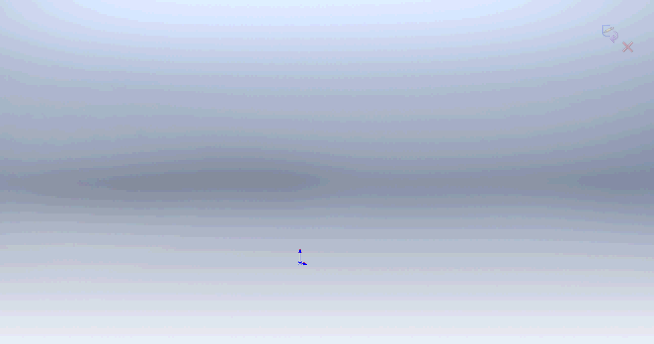

发表于 2013-6-26 14:22:19 | 显示全部楼层 来自: 中国浙江杭州
受梁兄感染,也来玩这个“点作图”,去发现宏作出来的点并不精准,很疑惑
1 E. i2 ?/ v; A, Y- D 零件3.gif
