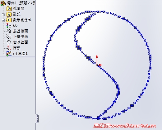

发表于 2013-5-27 15:37:29 | 显示全部楼层 |阅读模式 来自: 中国浙江嘉兴
2 H, G! r' l- B. |8 x* n# C: a# \  V. v& Z3 m# m9 @
學vba宏的基本教材8 z) Q, t( h# w
3 O; g2 L- O0 O. o9 B. }3 i'  macro recorded on 05/27/13 by lsc; d+ v* Q0 o* A5 C" Q; ^, F
2 |/ i$ A9 e1 r! \& a'  操作說明" T! e3 u8 l( L7 ~/ D. Y( e
/ c6 u  A. }% f" U2 G'  1. 開 excel sin_circle.xls 檔' W' z4 a' L) t5 V& b
'  2. 開SW檔,選前基準面(右或上皆可),進入草圖編輯,執行本程式., G) I  r# U# Z0 o1 l
'9 k# E& H2 T5 _$ h. E
& D8 A2 V; X2 s) x. {Dim swApp As Object8 h' f0 K. M4 J- \$ Z
Dim Part As Object2 W' X  O* G" v) F' O# h
Dim boolstatus As Boolean$ E0 X% p: y4 Y
Dim longstatus As Long, longwarnings As Long
4 m6 v1 I0 M" \; z* ASub main()8 e5 |1 r5 s* `
Set swApp = Application.SldWorks! P7 F$ |; a  e, y
Set Part = swApp.ActiveDoc
4 O* q6 r9 a9 b4 l- o; H'*** Attach to active Excel object
! {9 W/ |$ v* }& @+ {0 lSet xl = GetObject(, "Excel.Application")9 E3 m! T+ N% h7 S
'*** Get active sheet in Excel
) T( j' N0 r! B; m1 ?. |9 @8 ySet xls = xl.ActiveSheet; y" K4 p& u2 w
'*** Get value in Excel cell . y) Y6 |% E5 Z3 I
boolstatus = Part.Extension.SketchBoxSelect("-0.4", "-0.4", "0.000000", "0.4", "0.4", "0.000000") '$ d  U/ r' q/ s9 e8 `& U
Part.EditDelete
4 c' L2 ]( p) y/ b8 JFor i = 9 To 189' ~6 e; [! h- L; Q! r- w
X = xls.Cells(i, 3)
2 @6 }% r/ _8 l# b/ qY = xls.Cells(i, 2)5 A! Q* N) E! c
Set skPoint = Part.SketchManager.CreatePoint(X / 1000, Y / 1000, 0#) '點作圖 sin* T$ [, N3 F& o% M
X = xls.Cells(i, 5)
! `* @( Y) z! k+ UY = xls.Cells(i, 6)4 a! b1 H9 m+ r* o
Set skPoint = Part.SketchManager.CreatePoint(X / 1000, Y / 1000, 0#) '點作圖 circle2 S) u8 g  N9 @+ @( Z
Next
# n3 J* F! L5 m$ MEnd Sub
- T3 N' E9 A& v9 b$ v Clipboard01.jpg % X6 c( \; e. d' g
