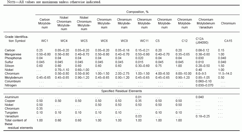

ASTM A217 WC6 是什么材料?; |/ d) v1 K. m- h' B/ W; [

Designation: A 217/A 217M – 02
: E; d9 Q8 O& d  m8 j% h! v" ]3 s: Q6 R0 v/ {. x4 ?! O- A
Standard Specification for Steel Castings, Martensitic Stainless and Alloy, for Pressure Containing Parts, Suitable for High-Temperature Service
