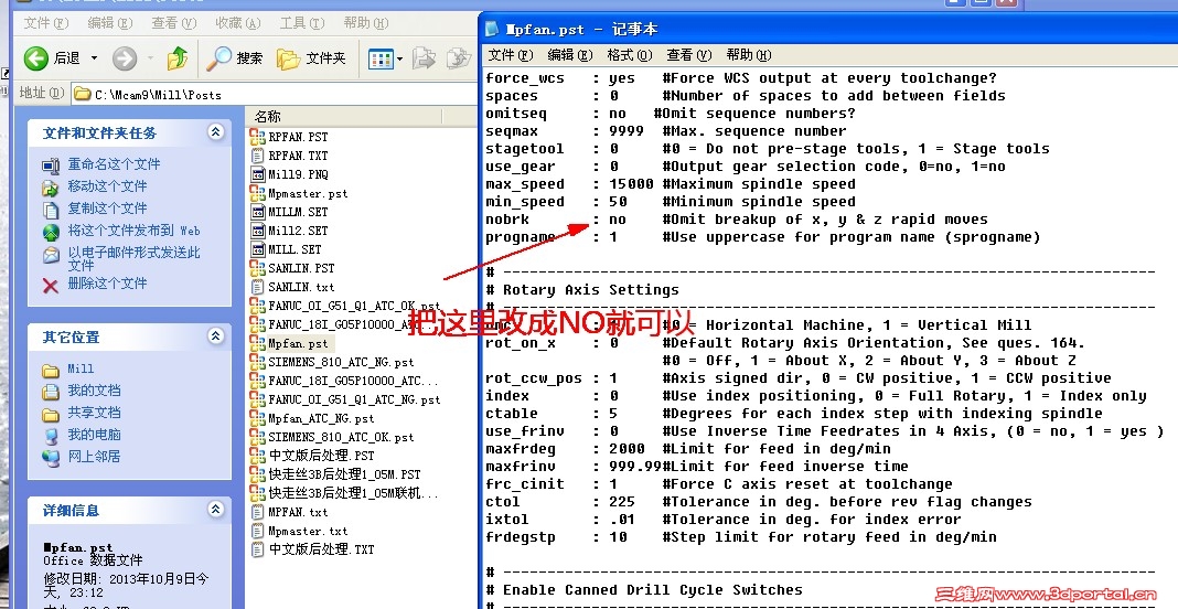

9版的要改后处理,找到Mpfan.pst文件用记事本打开,改成下面这样:" N# k- i6 C7 H- A/ R0 d
omitseq     : no   #Omit sequence numbers?
& ^$ Q! j; b. d) l: X1 T. t, G5 xseqmax      : 9999  #Max. sequence number
2 F7 f8 }2 H1 ]) `" Rstagetool   : 0     #0 = Do not pre-stage tools, 1 = Stage tools
" g0 d, s: [6 O7 w+ m0 ause_gear    : 0     #Output gear selection code, 0=no, 1=no
) \. N: J$ a. H6 K0 a MyCatch11.jpg
