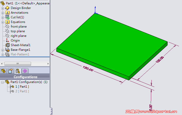

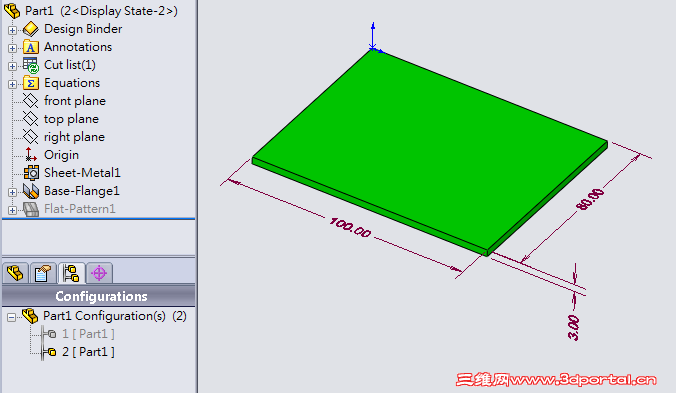

2010沒問題…8 ~  A9 L# ~7 F  O* Y3 D: h, V5 j

8 m% O' F$ q$ a 2.png * l6 S+ }" G. T  A# W* x: Y5 L
