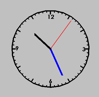

請幫忙測試,時鐘是否能夠同步電腦系統時間
2 z3 }" k: o/ ~+ V  K3 Z: g# U宏裡面的繁體字須更改為簡体,並對應秒分時三針的角度尺寸(請解除隱藏顯示)% x" ]+ `2 S5 r. w" J! P- U: Z2 G+ q
# L2 G- w' Q/ A- A' macro recorded on 12/24/13 by lsc2 Y( B3 @7 ?. U3 o& \* {
' 功能:同步電腦系統時間- L0 A# [# M& j  x7 x6 N  L
- n$ e. H7 F' s# D" Y' 操作說明:  k/ p' C8 v7 }" }) y# d$ X
' 1. 打開 now time.SLDDRW 檔./ J0 b( I% K7 h
' 2. 執行 Macro1.swp 巨集(宏)
! K9 l7 x1 ]' X0 ?0 f7 A4 k  H' 3. 須停止執行巨集(宏)時,請同時按下 Ctrl-Pause Break 兩鍵.
4 y9 ~' F" S* l' Y) u% a6 I/ R4 c'4 g0 }# o6 U' t3 B" y; x
9 b0 [, a3 H- o# _Dim swApp As Object* Y$ s) e  U, K
Dim Part As Object% b1 c  ]4 g$ A: e
Sub main()! t/ m" \  H# n7 O
Set swApp = Application.SldWorks
/ V' b' Z/ Q, T$ Z/ J( @+ P2 ?4 BSet Part = swApp.ActiveDoc
/ U8 n9 B8 ]/ ^. gDim sec_rad As Double
/ J; F7 J7 x9 y  a6 I3 U' `, m8 [. ?Dim myDimension_s As Object
" b8 h- i+ D7 z/ nDim myDimension_m As Object
: G% p. K; m) H" w% TDim myDimension_h As Object5 ]/ c2 b; \2 x9 }% A3 {8 E
Set myDimension_s = Part.Parameter("D8@草圖1") '對應工程圖秒針角度值
( {4 o6 B6 Z9 ]1 ~0 f" S4 ]Set myDimension_m = Part.Parameter("D9@草圖1") '對應工程圖分針角度值
! R3 J2 p3 ^* i2 V7 cSet myDimension_h = Part.Parameter("D10@草圖1") '對應工程圖時針角度值5 q* r$ X( U: J0 t0 o
pi = 4 * Atn(1)
4 J! w$ {8 O3 G( f" b" Vsec = Second(Time)" p0 a, M0 D& q6 q$ H
sec_rad = sec * pi / 30
8 F3 s( Z: c( T( zmyDimension_s.SystemValue = sec_rad '執行程式起始的系統秒# a! V% _; F; t6 e9 E  y& J* J* M
  z3 Q  h1 Q, N3 g2 N. r, A7 ZWhile hor < 13. I$ A( w2 X+ P  _
    sec = Second(Time) '系統秒
' G0 i7 u* c( R3 N1 L    min = Minute(Time) '系統分, C- I8 A2 u) c+ Q; g5 h' M
    hor = Hour(Time) Mod 12 '系統時(12小時制)- U# n: S/ v) O6 \
    sec_rad = sec * pi / 30 '秒針轉動弧度
( Z, T8 E$ W5 @! x    min_rad = min * pi / 30 '分針轉動弧度2 f; e+ l0 K: Q1 n& `" a1 y( G
    hor_rad = hor * pi / 6 + (min * pi / 360) '時針轉動弧度" w' E5 O, ~% l! G" I
    myDimension_s.SystemValue = sec_rad! ]$ K' G; M: p$ {5 ]1 N
    myDimension_m.SystemValue = min_rad
0 {# B- P( l5 Z    myDimension_h.SystemValue = hor_rad( X. A6 f) m8 S" j5 g: C
    Set myModelView = Part.ActiveView
9 r; F9 f1 l3 @& R5 w! x    myModelView.RotateAboutCenter 0, 0
' D6 U+ J' N) f7 _: r- c9 B! m& \; cWend
" Y. G1 p8 ~6 M6 cEnd Sub+ `! V3 N0 J! c% l! M6 T+ p6 n

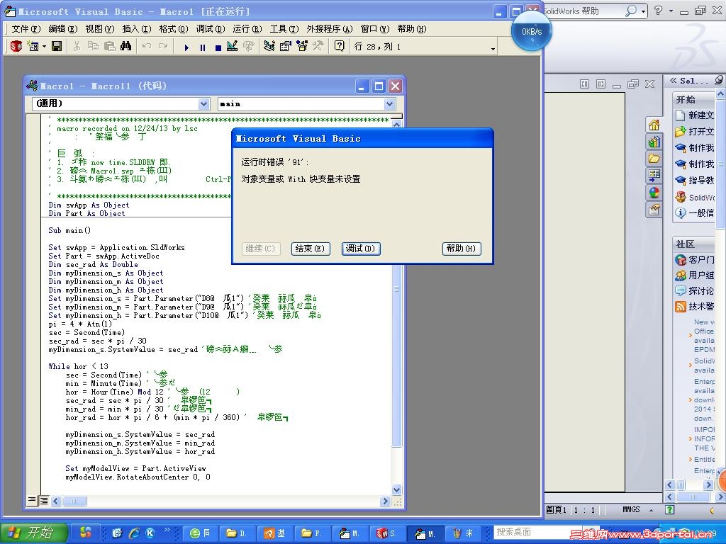

发表于 2013-12-25 09:21:02 | 显示全部楼层 来自: 中国天津
好东西
发表于 2013-12-25 09:36:03 | 显示全部楼层 来自: 中国天津
大师为什么我电脑运行不了?请帮忙看看
1 {% p' I. B' G5 }% ?) W9 F
 楼主| 发表于 2013-12-25 09:46:48 | 显示全部楼层 来自: 中国浙江嘉兴
! Z. j( e4 H: q- t' Z" {' q3 E6 C' O  I
dyltj 发表于 2013-12-25 09:36 static/image/common/back.gif
5 ~$ X  B5 B) Z) l+ t大师为什么我电脑运行不了?请帮忙看看
3 o/ Y6 U" ~3 z, Q& T2 e1 }已有提示了!
" }: F- Q) l8 y. h: M) ?9 G1 q簡繁版的問題,如下"草圖"是繁體字,須手改為簡体字,並對應作图角度之尺寸名稱.
3 _* K( y8 X+ H" @7 G1 i! \; USet myDimension_s = Part.Parameter("D8@草圖1")
' x# C/ W% P0 k! ~! `: G1 WSet myDimension_m = Part.Parameter("D9@草圖1") $ y. P2 Z  M" X: |9 d

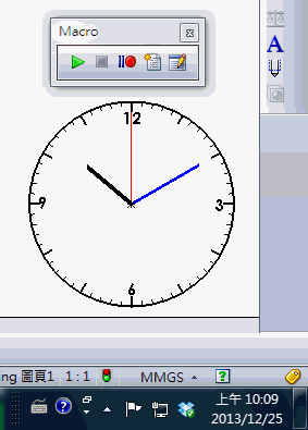

发表于 2013-12-25 10:04:33 | 显示全部楼层 来自: 中国台湾
! r1 e, q, c" c. p; q
( Y+ w" ~0 G3 O8 g很有趣的思維~謝謝梁兄分享,測試成功~~
# Q; ~* f/ O3 U7 s
. p: D3 Z  M( `% B5 [/ r capture-1.gif / `9 Z% q  ~: [" ~+ N
8 p- d) z. S+ w5 C2 V! n) ~6 M8 g# R+ t4 }( ?- v9 ^
5 y8 }/ x+ w% E! P+ m+ B8 T( p' H1 {: ?2 t8 l% u! d
 楼主| 发表于 2013-12-25 10:30:15 | 显示全部楼层 来自: 中国浙江嘉兴
gt.adan 发表于 2013-12-25 10:04 static/image/common/back.gif
4 |3 k9 F  V4 k- r8 ?很有趣的思維~謝謝梁兄分享,測試成功~~
" J! p; x1 Y) f7 h( M感謝丹兄支持
发表于 2013-12-25 10:47:11 | 显示全部楼层 来自: 中国天津
ryouss 发表于 2013-12-25 09:46 static/image/common/back.gif) D7 C) V% P+ x6 s8 X5 S7 x) L! k5 F
已有提示了!' Z* ]( z, P- ~$ a9 }
簡繁版的問題,如下"草圖"是繁體字,須手改為簡体字,並對應作图角度之尺寸名稱.& z; j$ p  v' l- X4 c; O# F# x4 x& C
Set myDimen ...
; V3 C  m9 W: [  _7 _大师高人,我按大师上面给的宏重新拷贝了就正常启动了
