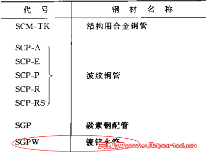

sgpw3 ^3 ]* w7 R. y/ P. M4 a4 @
JIS G3442 Galvanized Steel Pipes for Water Service (SGPW)
" J& V8 m4 U6 M6 h4 Q: p( a镀锌给水钢管
