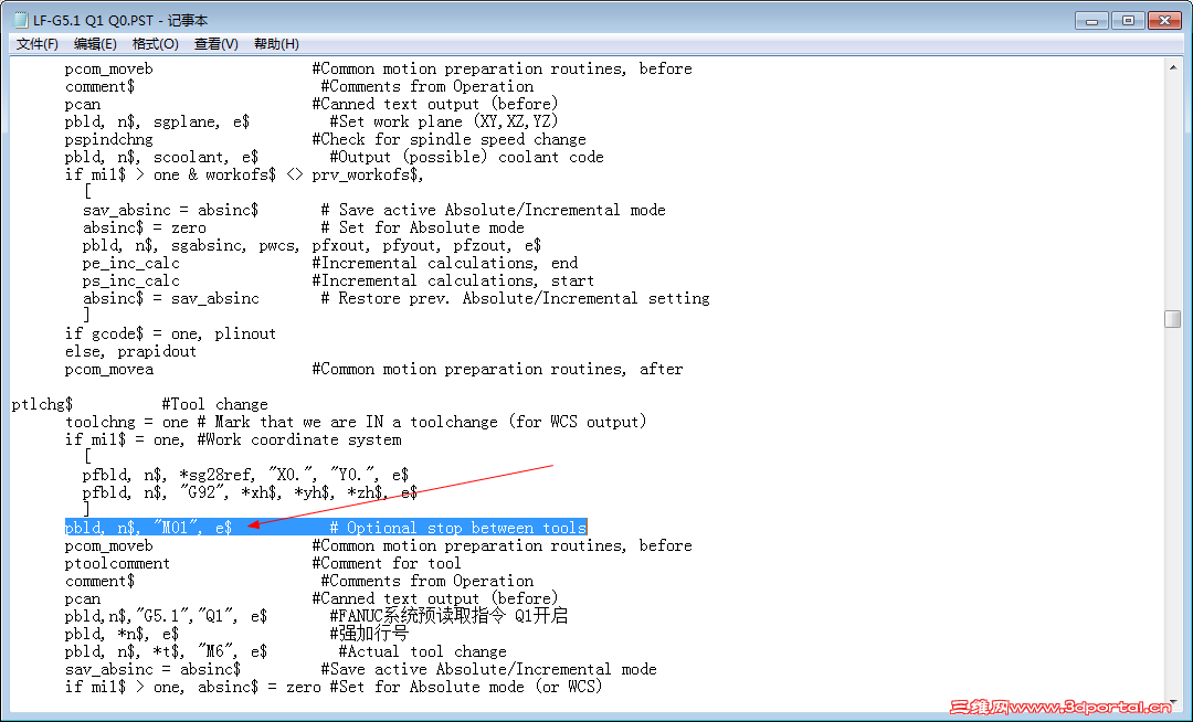

怎么样让后处理出来换刀时不用出M01?

查找pbld, n$, "M01", e$           # Optional stop between tools
) E4 J2 B9 T. t( N3 w0 ^变为#pbld, n$, "M01", e$           # Optional stop between tools! }$ l# u8 I4 C4 `$ s( K: y
就可以了。

 楼主| 发表于 2015-1-20 23:37:53 | 显示全部楼层 来自: 中国湖南衡阳
呵呵仙 发表于 2015-1-20 23:17 static/image/common/back.gif9 Z) R- E. v5 [) g# S( p* ]
# K( N$ X2 B* h2 K变为#pbld, n$, "M01", e$            ...
$ r& w% n& \# f9 Y8 @5 g谢谢你  OK
