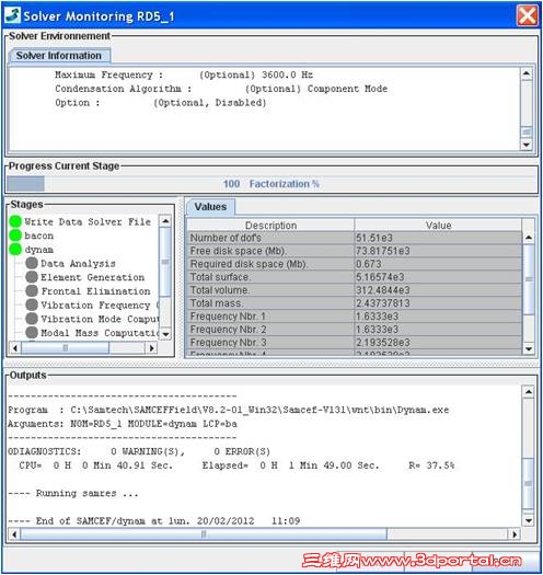

二维转子动力学模型不仅可以用于系统的简化分析,也可以对其进行超单元生成,然后作为次级部件导入其他系统模型中。需要指出的是,超单元生成的计算,没有任何可以显示的三维结果。
通过对本案例的介绍,可以了解到samcef在超单元生成方面的功能,主要包括:
·        Howto define 2D rotor geometry in Field (vertex, lines, face)
·        Howto define an elastic material
·        Howto create a superelement from this 2D geometry
·        Howto create a model, and import the superelement in it
·        Howdo define a Lumped mass attached to the superelement
·        Howdo define a Ground bearing  linked to retainednodes of the superelement
·        Howdo define locking on translational degrees of freedom of the superelement
·        Howto perform a “critical speed” analysis (ROTOR) of the model containing thesuperelement
·        Howto examine the results and report them.
       How to perform recovery ofthe superelement and see internal modal displacements+ T9 k# T) t0 v( k* d2 J. z3 S
. D0 e  G& \- ]0 Q+ B5 X SE.jpg 1 J8 Q3 @' y, w8 z2 \
附件为本案例的具体操作介绍。
