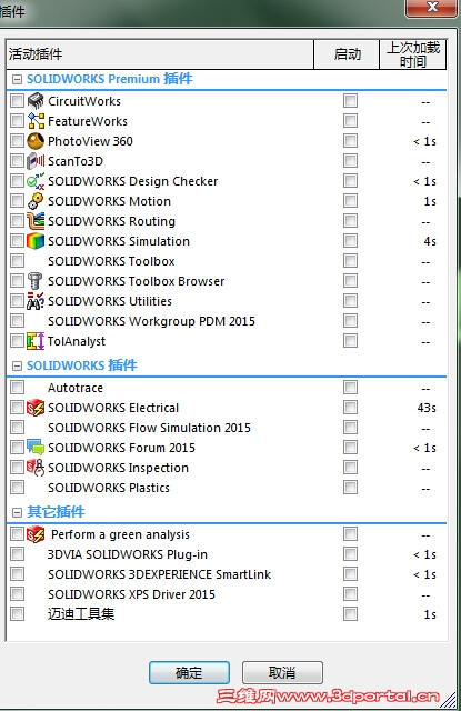

大家好 我的solidworks 2016 怎么 没 simulation插件和Montion 插件

你确定???安装时不是可以勾选的嘛,但是默认是勾选的嘛3 w1 M/ D7 \5 S6 O( z
你点工具-插件-查看呢

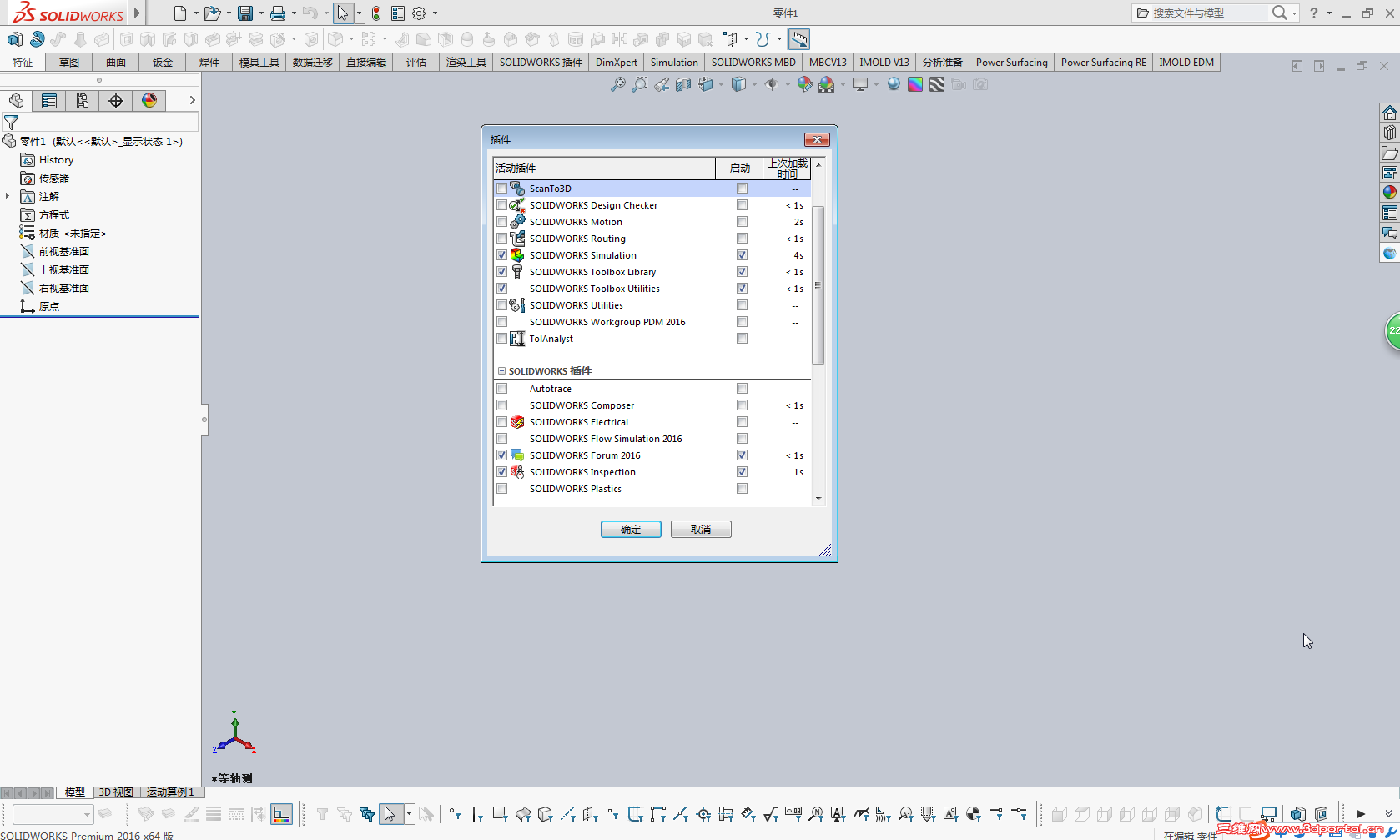

是不是安装时没有选择安装,我的全有

要卸干净之后重装。安装前要先搞搞那个什么系统补丁
发表于 2015-10-22 11:38:18 | 显示全部楼层 来自: 中国河北唐山
补丁3872630卸载

This maybe where the Windows Update KB3072630 is catching you out, unfortunately this update has caused some issues when SolidWorks is doing Installs. If the registry fix did not work, then the best cause of action is to access your Windows Updates, installed updates and remove this one (KB3072630). Once removed, remove SolidWorks from the machine and then reinstall - this should then include all the add ins as required, Providing your Serial number is premium as you say and there is not a problem with it. If this doesn't work contact your VAR., [, i& ?& z! F3 C4 f5 A
要卸载的是 KB3072630
