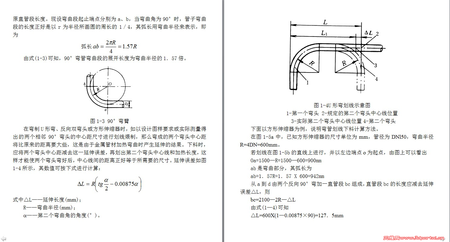

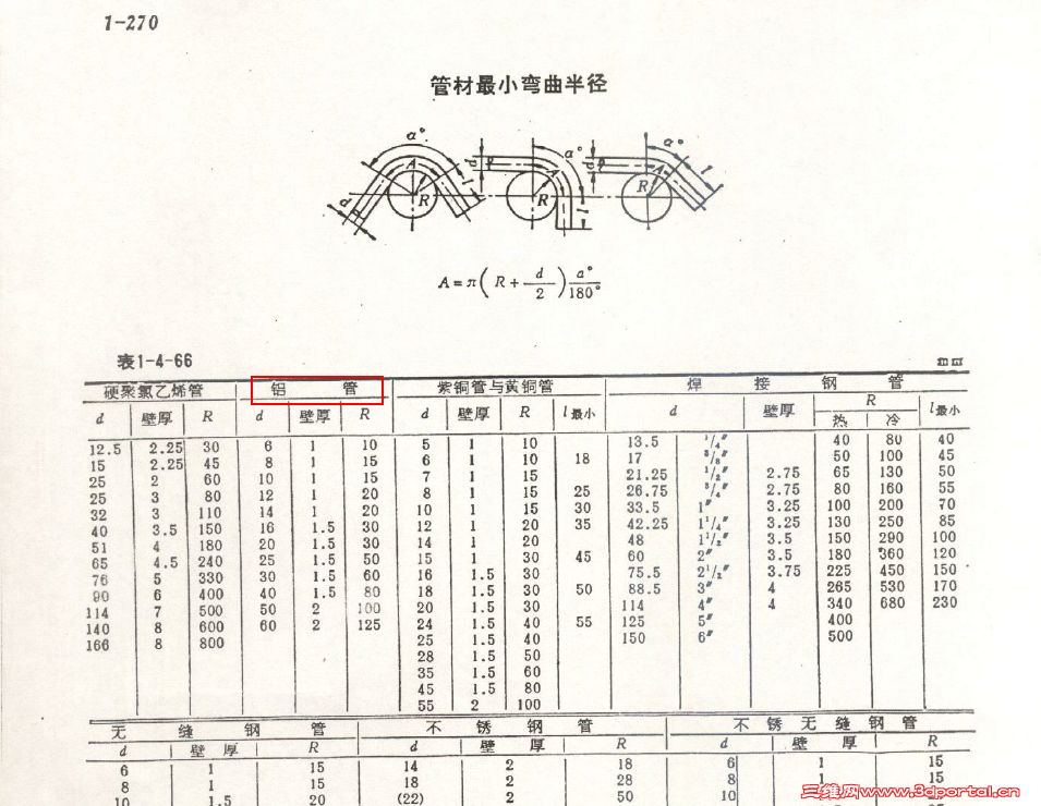

1.各种材料管子最小弯曲半径, {3 n8 {5 {& Z1 |- f
" i- j3 H+ s  `" W5 L5 C( E% f+ t2 h2.弯管一般知识及计算下料
  I. z8 P% k6 R, U" d/ E XR0ZBG8BAFK@00Z4`AM8P25.png
