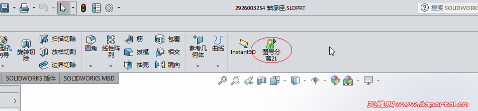

执行宏前图号名称没有分离
执行宏前图号名称没有分离
未执行前的图号名称没有分离

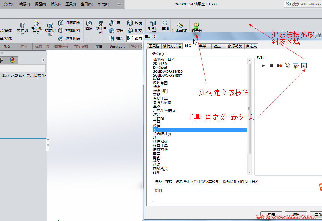

宏按钮设置
宏按钮设置
$ u+ h  Z3 c+ A

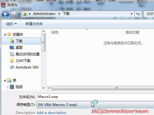

关键是宏按钮的新建:打开工具-宏-新建-另存为对话框-自己给起名字-复制填写代码 搜狗截图20161108080505.png . A5 j0 Z7 x: G: E: D
另存为对话框" c8 k4 l' W( Y, U- j7 a5 s% @
搜狗截图20161108080829.png " W& E- n5 Z: S0 S

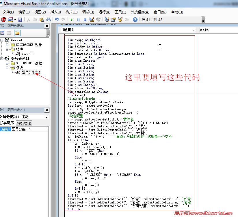

代码可以复制下面的-最后点保存- G3 \0 f; I2 R! u
下面是按钮制作

Dim swApp As Object
Dim Part As Object
Dim SelMgr As Object
Dim boolstatus As Boolean
Dim longstatus As Long, longwarnings As Long
Dim Feature As Object
; p( N$ f% }) W( w
  B2 o) o5 h  X  L
Dim a As Integer
Dim b As String
Dim m As String
Dim e As String
Dim k As String
Dim t As String
Dim c As String
Dim j As Integer
Dim strmat As String
Dim tempvalue As String
# j0 `8 w: P+ f2 I: @' U8 _- j& p8 r3 _. t* k6 c0 k
5 j& H2 U# I- n0 A) z. _
Sub main()
6 N5 _- R( w8 Q0 r5 V
'link solidworks
Set swApp = Application.SldWorks
Set Part = swApp.ActiveDoc
Set SelMgr = Part.SelectionManager
swApp.ActiveDoc.ActiveView.FrameState = 1
- ^5 e4 D4 C& n( K. J5 I# H
'设定变量
c = swApp.ActiveDoc.GetTitle() '零件名
3 g5 C) z6 x" M1 T7 \6 d+ x: n
strmat = Chr(34) + Trim("SW-Material" + "@") + c + Chr(34)
1 n4 J9 J4 D- Z7 n  o
blnretval = Part.DeleteCustomInfo2("", "代号")
blnretval = Part.DeleteCustomInfo2("", "名称")
blnretval = Part.DeleteCustomInfo2("", "材料")
. _) Z4 T4 j4 I  |3 z
" M. _  d  j; t
a = InStr(c, " ") - 1      '重点:分隔标识符,这里是一个空格
If a > 0 Then
    k = Left(c, a)
    t = Left(LTrim(e), 3)
2 k$ c( P8 ^( U) b
    If t = "GBT" Then
        e = "GB/T" + Mid(k, 4)
    Else
        e = k
    End If
6 p% N$ \0 h1 r+ @& y" ]( Q
    b = Mid(c, a + 2)
    t = Right(c, 7)
    If t = ".SLDPRT" Or t = ".SLDASM" Then
        j = Len(b) - 7
    Else
        j = Len(b)
    End If
    m = Left(b, j)
End If
/ ]" F) |; ^; h9 X4 X
blnretval = Part.AddCustomInfo3("", "代号", swCustomInfoText, e)  '代号
blnretval = Part.AddCustomInfo3("", "名称", swCustomInfoText, m)  '名称
blnretval = Part.AddCustomInfo3("", "表面处理", swCustomInfoText, " ")
- }0 q4 s  G$ x/ {
End Sub

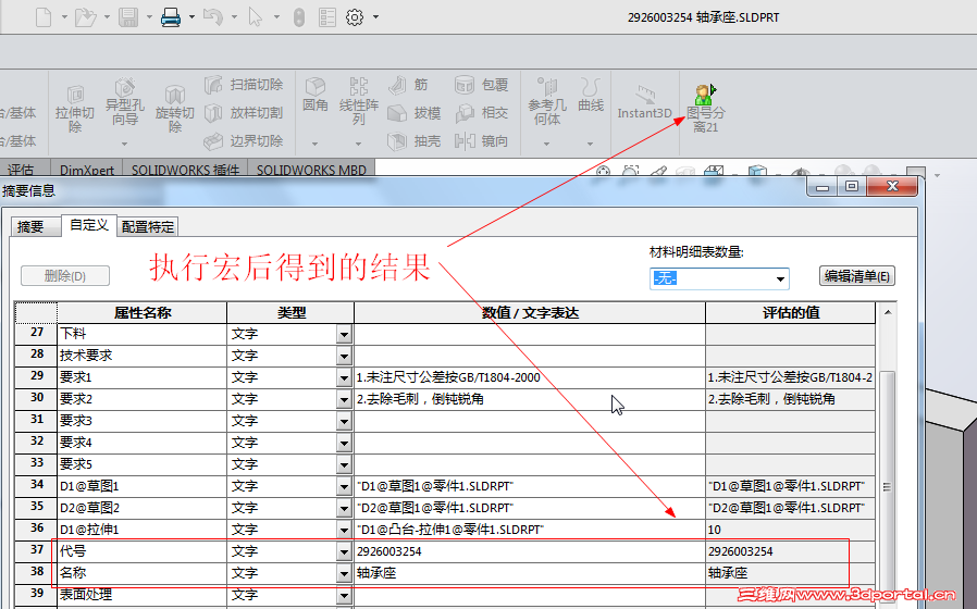

执行宏后图号分离
执行宏后图号分离
  D6 F% U/ E# x6 F' ~
点击按钮,执行后得到的结果。后续出工程图调用时使用。1 T2 Z# s7 Z6 v1 @  B& {  Z6 [

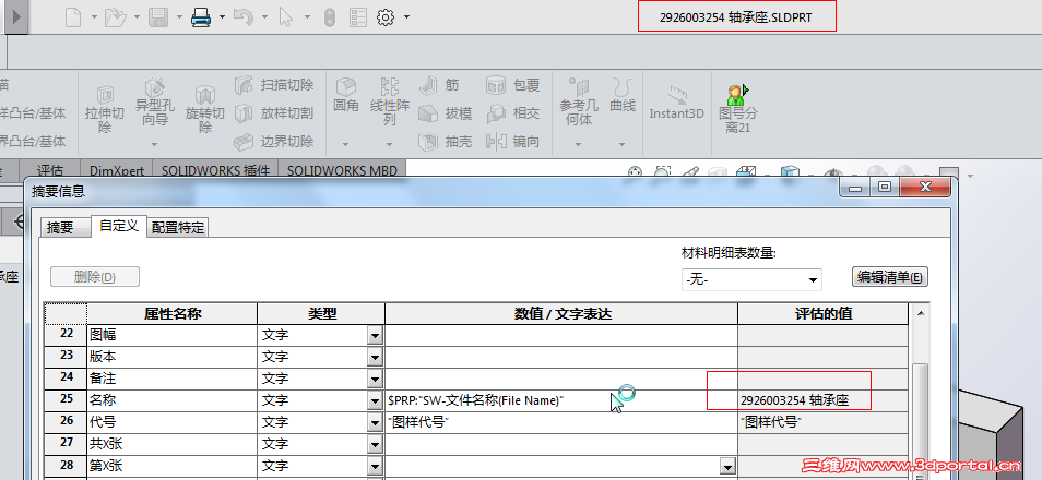

补充:零件命名规则,图号名称中间必须有个空格
