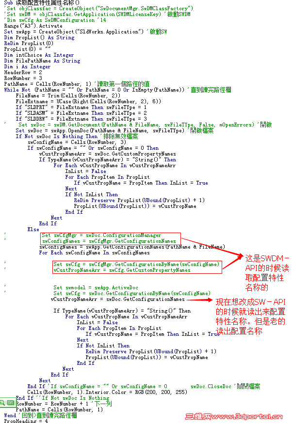

谁来帮我看看,这代码要怎么改,才能运行啊?2 O4 W; u6 D: T! {- N

  1. Sub 打开文件()' b' K: o# R* @2 r0 d& n
  2. Range("A3").Activate. o7 F) F( n4 g; P
  3. Set swApp = CreateObject("SldWorks.Application") '启动SW
    ' \7 E9 Z- E/ S6 Y
  4. Dim intChoice As Integer
    ) M: f- u. J8 }$ i. G1 Z1 C
  5. Dim FilePathName As String- |' N4 X0 z2 C& f3 z: {* [5 u
  6. Dim i As Integer9 K4 V# a' l' G3 o. B  q2 X4 i
  7. HeaderRow = 2
    9 r5 v5 b4 K' B3 v
  8. RowNumber = 3
    # h) \6 y  z! R3 |4 ^! b5 R0 L* s1 r
  9. PathName = Cells(RowNumber, 1) '讀取第一個路徑的值
    * q' B8 w6 @' I5 e6 a  s
  10. While Not (PathName = "" Or PathName = 0 Or IsEmpty(PathName)) '直到讀完路徑欄(尋找繼續填寫的位置)( c' f, d1 ?$ v& J; P, W! |
  11.     RowNumber = RowNumber + 1 '下一列+ ?$ h( H9 D  p! N+ k- t# ]0 B! _
  12.     PathName = Cells(RowNumber, 1)2 a- n: \" }) x9 Z
  13. Wend '回到>直到讀完路徑欄
      f$ ]. [$ Z% P+ I
  14. Application.FileDialog(msoFileDialogFilePicker).AllowMultiSelect = True '設定為多選對話框
    9 o- \% F3 f" p* f& g% D* J
  15. Application.FileDialog(msoFileDialogFilePicker).Filters.Clear '清除既有類型/ ]2 t* }3 e" Z* Y
  16. Application.FileDialog(msoFileDialogFilePicker).Filters.Add "零件自定义属性", "*.SLDPRT" '設定檔案類型
    * h- o# G) p: x: Z3 H7 K3 @
  17. Application.FileDialog(msoFileDialogFilePicker).Filters.Add "零件配置属性", "*.SLDPRT" '設定檔案類型
    ! j" z9 o& E" u; }0 \
  18. Application.FileDialog(msoFileDialogFilePicker).Filters.Add "装配体自定义属性", "*.SLDASM" '設定檔案類型" r! A$ E9 Y* r
  19. Application.FileDialog(msoFileDialogFilePicker).Filters.Add "装配体配置属性", "*.SLDASM" '設定檔案類型
    7 y; X+ t2 N6 q) y
  20. Application.FileDialog(msoFileDialogFilePicker).Filters.Add "工程图属性", "*.SLDDRW" '設定檔案類型4 d3 @3 o. {: r  G9 B3 y/ P
  21. If Cells(1, 1) = 1 Or Cells(1, 1) = 2 Or Cells(1, 1) = 3 Or Cells(1, 1) = 4 Or Cells(1, 1) = 5 Then  u% P4 E* Y/ _8 p! I
  22.     Application.FileDialog(msoFileDialogFilePicker).FilterIndex = Cells(1, 1)2 Q/ A1 I% w7 ~$ i3 g" M/ O2 b/ }/ r
  23. End If
    , H/ Q4 n' E. Y8 u: g/ U: G2 Z6 c
  24. If Cells(1, 2) <> "" Then Application.FileDialog(msoFileDialogFilePicker).InitialFileName = Cells(1, 2). }; W- j! c3 \
  25. intChoice = Application.FileDialog(msoFileDialogFilePicker).Show '彈出對話框
    2 Z1 ~4 _: M9 o9 S
  26. 2 c+ e1 k. O7 Z8 E  R. x2 U
  27. If intChoice <> 0 Then '判斷有否點選檔案. B' \, h( A' a. b  ]3 I; k
  28.     RowCount = 1
    ) @) L5 ]- \4 p4 M3 d- U
  29.     swFilterIndex = Application.FileDialog(msoFileDialogFilePicker).FilterIndex$ X; j% _5 Z3 T9 A/ E6 z
  30.     For i = 1 To Application.FileDialog(msoFileDialogFilePicker).SelectedItems.Count '逐一讀取所選檔案% w) i" k' @# h3 _
  31.         FilePathName = Application.FileDialog(msoFileDialogFilePicker).SelectedItems(i) '讀取完整檔案名稱
    6 w4 @" q) b- `; D7 Q- c6 S
  32.         FilePath = Left(FilePathName, InStrRev(FilePathName, "")) '分解路徑
    9 k' O9 D: t7 E+ }/ j
  33.         FileName = Right(FilePathName, Len(FilePathName) - Len(FilePath)) '分解檔案名稱
    8 B& h0 q. R2 S: n$ N. f9 n
  34.         FileExtname = UCase(Right(FilePathName, 6)) '分解檔案類型
    6 k9 Y, A- k# a1 |. ~+ m" ]
  35.         If swFilterIndex = 1 Or swFilterIndex = 3 Or swFilterIndex = 5 Then
    % X5 W2 S" r* s) f6 `( V
  36.             Cells(RowCount + RowNumber - 1, 1) = FilePath '填寫路徑
    " M0 D3 Y5 `) u/ t+ {
  37.             Cells(RowCount + RowNumber - 1, 2) = FileName '填寫檔案名稱
    , ^( g9 x+ b3 c# T* t0 r/ y
  38.             RowCount = RowCount + 1
    1 M( T7 S6 n0 S) y  O
  39.         End If5 j+ y0 _( u& H0 p6 ]# j& p# P
  40.         If swFilterIndex = 2 Or swFilterIndex = 4 Then '過濾器是2或4
    - F+ s5 N' Y/ A
  41.             swConfigNames = swApp.GetConfigurationNames(FilePathName)
    * `+ e- w1 S3 j: \
  42.                 ConfigColor = 200: H# e2 E+ u7 T! w1 P+ p1 S
  43.                 For Each swConfigName In swConfigNames
    9 |) d* \! F7 k! I3 S: c1 z. y
  44.                     Cells(RowCount + RowNumber - 1, 1) = FilePath '填寫路徑
    ' K6 D- d6 _" G& E# @
  45.                     Cells(RowCount + RowNumber - 1, 2) = FileName '填寫檔案名稱
    3 \+ g' a3 S0 [& j  P, R9 T, x$ }
  46.                     Cells(RowCount + RowNumber - 1, 3).NumberFormatLocal = "@" '设为“文本”格式" g0 {0 B5 h6 l1 K
  47.                     Cells(RowCount + RowNumber - 1, 3) = swConfigName '填寫模型組態名稱* v& l( K$ |2 P0 I4 k; A9 h9 E* Q
  48.                     Cells(RowCount + RowNumber - 1, 3).Errors.Item(xlNumberAsText).Ignore = True '去除三角错误6 {. M. Q0 [1 }2 g
  49.                     Cells(RowCount + RowNumber - 1, 3).Interior.Color = RGB(ConfigColor, ConfigColor, ConfigColor)0 n4 L( o3 g& k) c5 y2 N, d2 J9 W
  50. 9 v7 d8 ~, M! e1 ^! h
  51.                     RowCount = RowCount + 1
    3 E. p% |) X7 o! X- ?; o
  52.                 Next
    / q8 K9 `8 p/ z* r
  53.             End If '排除無效檔案<完>3 ?( D( X9 M: v" r
  54.     Next i '逐一讀取所選檔案<完>0 A: ^' B  q$ G  ?- x2 q
  55. End If '判斷有否點選檔案<完>! L5 q. F6 u& o$ @
  56. End Sub
    - K/ b# {  m9 y$ ^9 z( K# J
  57. % m. I0 {, L  a& z  K
  58. Sub 读取配置特性属性名称()
      i$ R0 y: A& `: Y6 J2 j. b# ^
  59. 'Set objClassfac = CreateObject("SwDocumentMgr.SwDMClassFactory")2 h( U& O6 A( r! Q8 `7 Y4 T, \+ c% K5 c
  60. 'Set swDM = objClassfac.GetApplication(SWDMLicenseKey) '啟動SWDM
    & \6 v: x  L) s  e$ q
  61. 'Dim swCfg As SwDMConfiguration '14
    # `0 M2 s# W* ]4 G  M0 M
  62. Range("A3").Activate
    + q2 ^; O5 O* E7 {3 i7 F9 Z% d4 ^
  63. Set swApp = CreateObject("SldWorks.Application") '啟動SW  s6 e4 K8 Y7 a: e) S# Y) j/ c2 s+ h
  64. Dim PropList() As String
    9 U0 V$ W/ r( J  o  {
  65. ReDim PropList(0)
    ' ~2 L5 o# N9 {- }
  66. PropList(0) = ""
    7 d9 k- G, Q" z0 [! L
  67. Dim intChoice As Integer$ T  s+ q% n1 G: p/ U
  68. Dim FilePathName As String
    / A, t3 W. P- ]& N$ G2 n
  69. Dim i As Integer
    . }  n  k7 E: e" z9 O/ c' ^7 B9 j
  70. HeaderRow = 28 @& A% z: M# S
  71. RowNumber = 3
    5 {. H. v/ Y1 r  N* C
  72. PathName = Cells(RowNumber, 1) '讀取第一個路徑的值1 n+ z- n% f1 s1 q: a: t* w& g
  73. While Not (PathName = "" Or PathName = 0 Or IsEmpty(PathName)) '直到讀完路徑欄
    " u" `4 h$ K1 ~3 E( ]! J- |' J
  74.     FileName = Trim(Cells(RowNumber, 2))8 Y8 \# V' Y& m2 M" t" S
  75.     FileExtname = UCase(Right(Cells(RowNumber, 2), 6))
    ! b8 K: r% @$ E! w+ A
  76.     If "SLDPRT" = FileExtname Then swFileTYpe = 1( M/ P( C' J! A/ R9 u& z
  77.     If "SLDASM" = FileExtname Then swFileTYpe = 22 d0 r: Y  `1 J# W
  78.     If "SLDDRW" = FileExtname Then swFileTYpe = 38 S" M. C  \" R- R
  79. '    Set swDoc = swDM.GetDocument(PathName & FileName, swFileTYpe, False, mOpenErrors) '開啟; d: p4 ~, Z) W9 G+ V9 s) p* Y
  80.     Set swDoc = swApp.OpenDoc(PathName & FileName, swFileTYpe) '開啟檔案
    ( O2 J2 e2 j$ h9 n- }" {* v; R. t  g
  81.     If Not swDoc Is Nothing Then '排除無效檔案
    ! G+ Q! Q) D8 r
  82.         swConfigName = Cells(RowNumber, 3)
    7 n. R: @4 ]" Q* h7 M
  83.         If swConfigName = "" Or swConfigName = 0 Then( V. X0 k) l1 c9 i) {# k1 h! n' f
  84.             vCustPropNameArr = swDoc.GetCustomPropertyNames
    7 A4 U# B) ?0 n& L9 n
  85.             If TypeName(vCustPropNameArr) = "String()" Then
    & m; _# U+ p! c
  86.                  For Each vCustPropName In vCustPropNameArr( G9 j' r8 f) s$ T
  87.                      InList = False
    1 {5 @' b1 c( ?" l+ e, _
  88.                      For Each PropItem In PropList
    ' L- D% C& G% s# K! G$ {! j
  89.                         If vCustPropName = PropItem Then InList = True
    7 k3 `3 ]9 y" c4 X/ J  h9 a" q  e
  90.                      Next/ O; z+ }" O$ T1 W
  91.                      If Not InList Then4 M, C$ ~, ?2 e6 P3 _+ G$ V
  92.                         ReDim Preserve PropList(UBound(PropList) + 1)/ ~+ [+ Q% A5 E5 V' U9 K- @; B
  93.                         PropList(UBound(PropList)) = vCustPropName
    9 q; E- n; ], h
  94.                      End If
    + j, _& J" W$ ~& O
  95.                 Next) j0 |3 I3 U1 E% V3 g8 ^
  96.             End If
    / D+ V+ _8 u7 W$ Q, ?1 r
  97.         Else
    3 \9 P# r! s6 ~3 A7 Q: B
  98. '            Set swCfgMgr = swDoc.ConfigurationManager8 s0 h; `4 _# ~* S1 P
  99. '            swConfigNames = swCfgMgr.GetConfigurationNames
    4 x0 L4 b: d* i# E" L
  100.             swConfigNames = swApp.GetConfigurationNames(PathName & FileName)5 u2 x* k" f3 U: v! n
  101.             For Each swConfigName In swConfigNames
    1 u" z; R& ~: @! P6 ?/ q
  102.
    2 m" C- n4 m- U# h
  103. '                Set swCfg = swCfgMgr.GetConfigurationByName(swConfigName)1 z0 H, B! [( F# q) Z- f$ C
  104. '                vCustPropNameArr = swCfg.GetCustomPropertyNames( ]$ S- N& X. F% m3 S4 ^7 E, h" O
  105. + y5 N3 U9 ?+ h2 t* _
  106. 0 ]* Z% F# \- D1 K+ q% [. Z! M
  107. '                Set swmodel = swApp.ActiveDoc: i# |/ S6 S) o% l
  108. '                Set swCfg = swDoc.GetConfigurationByName(swConfigName)! P, O$ _, J" z" o: v4 G# a' Y
  109.                 vCustPropNameArr = swDoc.GetConfigurationNames
    % _+ S, ^$ h8 U% M+ [
  110.                 7 |, ^! _; g7 X- r. S. J1 \9 }& s
  111.                  If TypeName(vCustPropNameArr) = "String()" Then
    ( e' ]- W1 ]8 S& s7 q3 \
  112.                      For Each vCustPropName In vCustPropNameArr
    $ b, q6 R: e- s2 D" o
  113.                          InList = False0 _( \3 [+ g" f* G# [
  114.                          For Each PropItem In PropList: O3 A! s" ~1 ?$ [0 W- n' Q
  115.                             If vCustPropName = PropItem Then InList = True2 P; f" h# z+ b
  116.                          Next- R7 D- C' `. s# s9 I
  117.                          If Not InList Then# k# S( Y5 q5 S* |* H3 R  v7 z
  118.                             ReDim Preserve PropList(UBound(PropList) + 1)0 A% H) s8 Q* f$ ^3 M3 m" q
  119.                             PropList(UBound(PropList)) = vCustPropName
    ' l  B/ v- g9 W6 d5 o% ^
  120.                          End If
    $ w% F* b. q0 W
  121.                     Next
    & \. n3 z( H( |% K3 n- ?! i
  122.                 End If
    + L& v# P4 K# O, {
  123.             Next/ V! m* L' s0 E& ~
  124.         End If 'If swConfigName = "" Or swConfigName = 0        swDoc.CloseDoc '關閉檔案. Z. t9 {8 V6 K  B# X
  125.         Cells(RowNumber, 1).Interior.Color = RGB(200, 200, 255)2 n" V$ n- D" p' M6 z- k
  126.     End If ''If Not swDoc Is Nothing7 ^& f) L7 b) n. Y
  127.     RowNumber = RowNumber + 1 '下一列
    . |' z; J3 _: X" ^
  128.     PathName = Cells(RowNumber, 1)
    ; L& y7 B+ S( H: K5 [/ J- e1 B
  129. Wend '回到>直到讀完路徑欄
    4 O; P7 a8 H; n: ^1 J
  130. PropHeading = 4
      o3 e" H0 {& b! ~& }! o
  131. For i = 1 To UBound(PropList) '- 1
    ! [1 g. F/ R- L$ G
  132.     Cells(HeaderRow, PropHeading) = PropList(i)/ R- y  E1 j( @) s/ `
  133.     Cells(HeaderRow, PropHeading).Font.Bold = True
    ; ~4 [4 |5 g: e' P/ h3 D2 [
  134.     PropHeading = PropHeading + 11 R' l# P8 t; E# O5 K2 K
  135. Next
复制代码

发表于 2016-12-28 15:01:43 | 显示全部楼层 来自: 中国台湾
你沒有SWDM的許可號,怎麼運行?- o- ?5 t  d3 S
好比一台跑車,沒有鑰匙,怎麼啟動?
