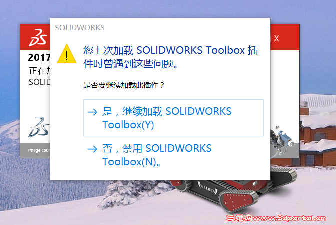

solidworks2017 您上次加载solidworks toolbox插件遇到问题* i' v, m; V, R/ }% t" x% W6 q
, p1 }; _6 m# Q8 J6 B4 ~( s: k1 g一选 是 就显示内存不足,退出
+ x6 Q& |$ K  ]0 G$ X! {3 h9 F谁知道怎么解决啊

You have to go to directory C:\Users\ "user name" \AppData\Roaming\SolidWorks\SOLIDWORKS 2017\toolbox\data- P; b0 h& p. c7 Q2 H( D
3 \5 v5 e# H1 |$ Band delete tb_default.sldedb file.

重装解决啦
% F. G- i2 M/ U( Y6 E4 J还是谢谢啦
