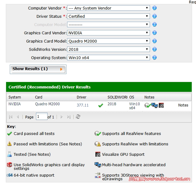

20171030172902.jpg 8 P  q3 R, R, r8 r' D% E
用官网驱动试试- x9 @- v0 c1 [' g9 j# ]0 o+ ^
http://www.solidworks.com/downloads/videocarddriver/nvidia/377.11-quadro-grid-desktop-notebook-win10-64bit-international-whql.exe
& Y* u0 C) v/ q& |# t另外RealView 功能不建议开启
  P( w% u7 k8 q9 F9 F8 F( g. H

 楼主| 发表于 2017-10-31 10:47:15 | 显示全部楼层 来自: 中国上海
shui2012 发表于 2017-10-30 17:30
+ \; X! H% E0 T  @, F用官网驱动试试9 w" A6 ^# M) [6 M9 g7 U- X& F
http://www.solidworks.com/downloads/videocarddriver/nvidia/377.11-quadro-grid-desk ...
1 W3 w: U- _; g+ A# g- s; |这个官方驱动我也安装了,但问题一样没有解决,还是非常卡。) f6 R, I+ e, o. `0 A: [& L* b
RealView无论开与关,都是一样的超级卡顿!5 w7 Y% b: @$ p. w5 ^
