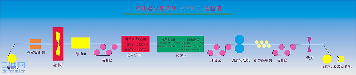

冷轧退火酸洗线
* K6 k  D/ X/ u0 {* [[attach]CAPL-pic冷轧退火酸洗线[/attach]# Z: W- p! R' V+ u& u  r8 M

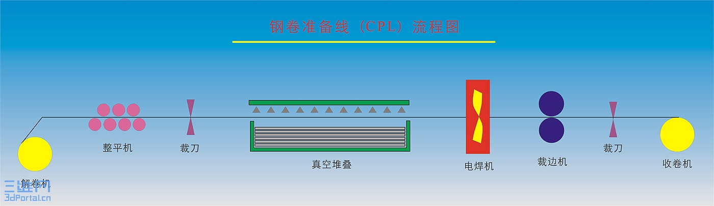

钢卷准备线
' b0 c. r6 |+ s- c1 u+ V4 t[attach] CPL-pic钢卷准备线.jpg[/attach]

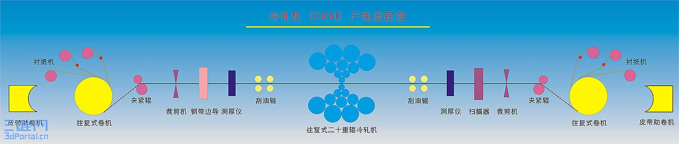

: i6 W8 T+ s. S4 I/ J; e8 L& {. w/ X往复式轧机
  K8 Y+ n3 b: U) |' w[attach]CRM-pic往复式轧机.jpg [/attach]

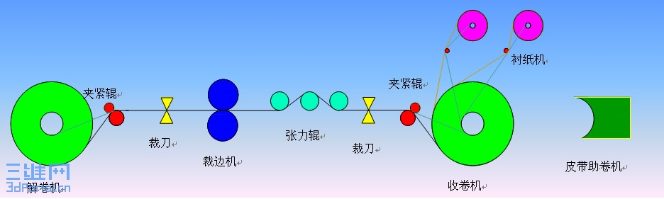

4 m* a0 i' C) H/ j. Q  `1 u钢锩裁边线0 \  U- L7 i: I
[attach]CTL-pic钢锩裁边线.jpg [/attach]

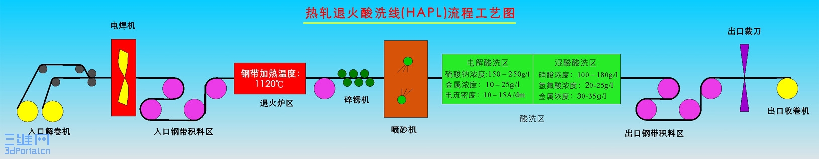

6 f( E  s" Z2 W- g% D6 c2 L! c; j热轧退火酸洗线- r3 g8 k, u# C2 A
[attach] HAPL-pic热轧退火酸洗线.jpg[/attach]! L# z$ Q1 s  b7 c

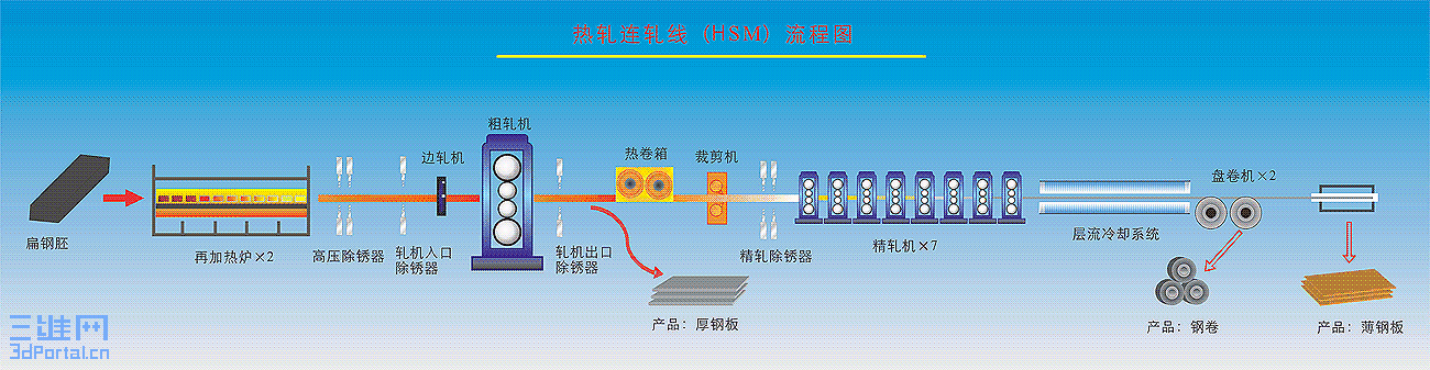

热轧连轧流程图; x6 }, @$ M- _! O0 Z8 R6 R- f
[attach]HSM-pic热轧连轧流程图.gif[/attach]

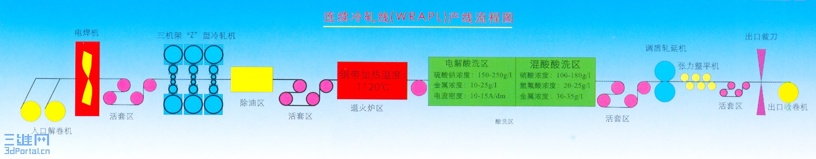

" l& Z& m4 @2 E+ o  }连续冷轧线(WRAP)/ e, F- ]; M9 B, P# P
[attach]WRAPL-pic连续冷轧线(WRAP).jpg[/attach]
