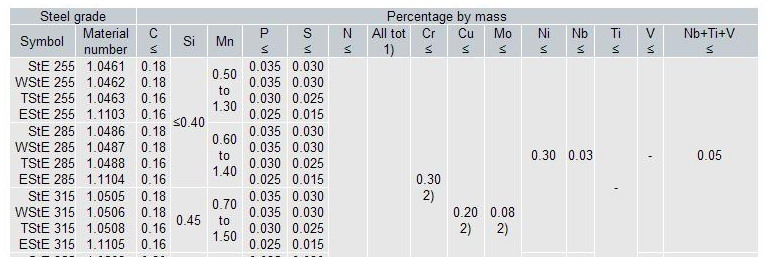

发表于 2007-2-25 22:54:38 | 显示全部楼层 |阅读模式 来自: 中国河北唐山
·      The shell of the mill must be made of welded steel plate elements with the following mechanical       characteristics :1 [5 z) n; g/ p: k5 n  J, l
  p; c; k9 E/ R1 |7 i4 F  z
Rm ³ 360 MPa.# c+ h4 N) S, e9 k: h4 x
Re ³ 225 MPa." d; s7 b/ i! P" g6 ~6 a
A% > 22.
4 j9 r; @$ x4 b6 [8 E6 }' ` ' M; k: @& E$ a; s+ e1 G
For example, the steels that respect these values are as follows :; n) V( N+ Y8 c, `6 R8 t
6 J+ z. |- l; n! ?( q, I6 f- WStE 255                   : DIN 17 102 Mat 1.0462& B3 g( _8 f/ E2 i# [; P1 T' O
- A42CP or P265 GH   : EN 10028-2 (92)# x; u) z( Y- U* @
            - H II                                  : DIN 17 155 Mat 1.0425
发表于 2007-11-1 17:45:38 | 显示全部楼层 来自: 中国浙江湖州
看样子是低碳钢(A)

发表于 2007-11-23 19:05:35 | 显示全部楼层 来自: 中国北京
elements不应单独抽出来作解!
7 R" v/ t; q/ X' u- }4 @9 a0 `0 e0 O) _1 ~
只是起一个承前启后的作用。% _3 o# f/ b# `0 x
" e8 H0 V8 \$ Y6 o/ }5 H即既要满足前半句的制造要求,又要满足后半句的机械性能要求!
