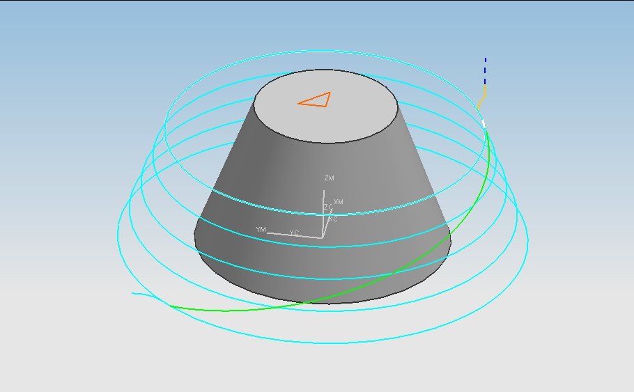

fh.jpg ' b. E" w1 e, h1 `, _& L; Z( a
) E7 [+ G2 u' y' V% {- h
为什么整圆工件而程序却是很多小段?甚至有的被处里成直线,这样的程跑起来很慢,而且也漂亮!
# p; @9 [& B' j! S! n6 }N0030 G00 G90 X19.126 Y-28.431 S2000 M03  M081 U8 P& o$ \! [8 a: X
N0040 G00 Z33., P: L% ~- W  S; e9 s* F
N0050 G00 Z27.
' a) S: k; e0 u: c/ VN0060 G01 X19.126 Y-28.431 Z24. F800.
9 p0 c) D) _  iN0070 G03 X13.129 Y-28.375 I-3.057 J-6.297
9 m& H8 i: I! _9 s& [6 UN0080 G02 X10.821 Y-29.333 I-13.127 J28.3689 p9 ^' o# v, \
N0090 G02 X-8.776 Y-30.008 I-10.819 J29.326( I7 P" b$ h! y- t( r, E+ P
N0100 G02 X-21.544 Y-22.655 I8.684 J29.842% e# A% a3 B$ \
N0110 G02 X-22.655 Y-21.544 I20.752 J21.863* {% t: A, G& K: Z. E3 `
N0120 G02 X-30.797 Y-5.386 I22.515 J21.476
% ?+ t: o; ?+ J" aN0130 G02 X-26.285 Y16.927 I30.787 J5.388
: y+ m1 ^9 o7 ]N0140 G02 X-8.776 Y30.008 I26.282 J-16.922
' M; A% C: P) B6 [) O3 p; e+ [N0150 G02 X16.927 Y26.285 I8.776 J-30.003# m2 f/ E- ]' a# j
N0160 G02 X25.227 Y18.466 I-16.827 J-26.177
# U; A: _! [% A9 s, z% D/ nN0170 G02 X26.16 Y-17.119 I-25.213 J-18.466$ M; l6 R7 \0 m4 E( X( P* }6 N
N0180 G02 X10.821 Y-29.333 I-26.158 J17.112
3 F) o  I. n0 w: d$ L. w$ SN0190 G01 X10.47 Y-29.499 Z23.8971 Z. ^5 W( o, J- @0 z! `, f
N0200 G01 X10.117 Y-29.662 Z23.793
2 H; y" j( |/ w7 hN0210 G01 X9.761 Y-29.82 Z23.69
. a) b9 U6 _6 a+ uN0220 G01 X9.404 Y-29.974 Z23.586
9 u* w( J) i- ^* CN0230 G01 X9.044 Y-30.125 Z23.483
, C2 V% C- m0 `/ f4 S! ^  l' kN0240 G01 X8.682 Y-30.27 Z23.379, Z/ ?8 S' I) e3 o  o! s# e5 n& o
N0250 G01 X8.317 Y-30.411 Z23.276/ Q: z# s/ |4 e1 m
N0260 G01 X7.951 Y-30.548 Z23.1726 T3 ~( z( P; s& J
N0270 G01 X7.582 Y-30.681 Z23.069% O) q9 z; z( h3 ]1 X& t
N0280 G01 X7.211 Y-30.808 Z22.9665 q$ O  g3 r8 X& e+ Z
N0290 G01 X6.838 Y-30.932 Z22.862
% A* m5 Z% M+ W3 U' {, t' FN0300 G01 X6.463 Y-31.05 Z22.759
1 k( I% d  f6 n, w2 ~N0310 G01 X6.086 Y-31.165 Z22.655% k; S) ^6 Z- r* F5 G8 _( O
N0320 G01 X5.708 Y-31.275 Z22.552" d( L$ p' [! S/ F$ K) ?
N0330 G01 X5.328 Y-31.38 Z22.448
" y: G3 [$ k4 |* M) L  |N0340 G01 X4.946 Y-31.48 Z22.345  _9 D9 V4 `( Z+ {
N0350 G01 X4.562 Y-31.577 Z22.241& p/ i1 m. _( b7 K
N0360 G01 X4.177 Y-31.668 Z22.138
7 s& c$ r+ q: \+ N, Z. \7 c% |N0370 G01 X3.79 Y-31.755 Z22.034...............................................(这么简单的刀路就有300多段程序?)

回答!
在机床输出的时候给个参数了,然后看看后处理有没有问题了。
