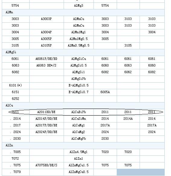

请问AlCuBiPb是什么材料,具体成分及性能,功用是什么???
发表于 2007-5-31 09:02:33 | 显示全部楼层 来自: 中国江苏苏州
这是一个德国牌号的,相当于变形铝合金2011.

发表于 2007-5-31 09:14:42 | 显示全部楼层 来自: 中国江苏苏州
EN AW-2011 / ISO: Al Cu6BiPb
& C3 v4 T, J; e; g. U$ @+ KComposition: Al 5.5Cu 0.4Bi 0.4Pb
' R8 A1 G. F9 `2 P5 X" T9 }Applications: Screw machine products: various machinery components. Screws, bolts, fittings, nuts, automatic lathe products. Applications where good machinability and high strength are required.
; b% ~4 D9 b6 n! p6 c; ?. ~Characteristic Properties: Excellent free machining characteristics. Heat treatable high strength alloy with a strength slightly lower than 2007 and 2030. High fatigue strength.
7 c  v' a9 Z% q( S4 W3 a# `Precautions and Warnings: Low corrosion resistance for outside applications. Hard anodizing or other protection is recommended.   {1 A9 |- c& D6 c% n1 A! E
Product Forms: Bar, Rod, Wire, Tube

DIN標准
: M8 a7 t4 q- W' z! n( w0 h- Q化学成分%
$ p* a" A; [- p$ S牌号 硅Si  铁Fe  铜Cu           锌Zn    Bi&Pb each    铝Al   DIN
2 E! |$ J7 i. J6 q8 F" S2011  0.4    0.7    5.0-6.0        0.3      0.20~0.60         Rem  AlCuBiPb

发表于 2008-3-28 16:54:24 | 显示全部楼层 来自: 中国福建泉州
:lol: :lol: 看看下表:
