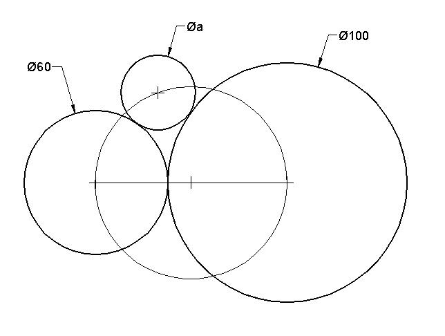

原题在:http://www.3dportal.cn/discuz/viewthread.php?tid=233155&highlight=%BE%9A%C1%95%EE%7D
: `. B: }7 _" F
9 s" I2 E1 N: l) s/ M【进修级练习题2】求:
3 A. ]+ e7 R; K( x# p a 之直径值为何?
" x1 c( ?- F6 n9 D3 c: o4 r$ j    (A) 31.3355   (B) 31.3535   (C) 31.3553
3 o' x, c3 u- v- O4 x2 w6 h附图:. v' H- K# b, `
0 U$ B; m2 g% h* @8 z* q7 @, [
+ q  j6 c5 v& b& V: T5 B- l【进修级练习题2】答案:- I0 ~1 P8 l; e/ V& Y
a 之直径值 = 31.3553,就是(C)% O5 B8 M. L! @( q9 O/ x" u: r
