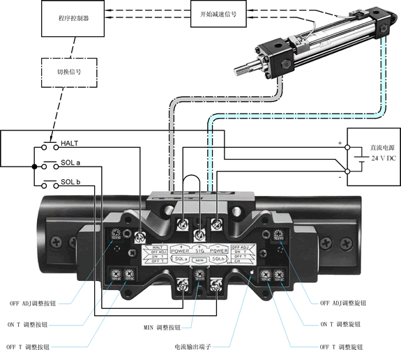

ÎÒÃǹ«Ë¾µÄÀ䴲Ϊ¶à×éÏàͬµÄµ¥Ôª×é³É,ËùÒÔ»ú¹¹µÄͬ²½¾ÍºÜÖØÒª.ÔÙÿ´Îµ÷ÊÔÉ豸µÄʱºò,Һѹ¸×Íê³Éͬһ¶¯×÷ʱ,×ÜÒª²»Í£µÄµ÷Õû,×ÜÒª±£Ö¤Ê±¼äͬ²½ÐÔ.ÎÒÏëÎÊÏÂÔÚµ÷ÕûҺѹ¸×ÔËÐÐʱ¼äµÄʱºò,¿ÉÒÔ²ÉÓÃÁ÷Á¿¿ØÖÆ·§,±ÈÀý·§¿ª¿Ú¶È.»¹ÓÐûÓбðµÄ·½·¨°¡?Ïò»»Ïò·§µÄ»»Ïòʱ¼äÖ®ÀàµÄÓÐûÓпÉÄܰ¡?СµÜ¸ÕÈëÐÐ,Ï£Íû¸÷λָµãÏÂ,µ÷ͬ²½Ö÷Òª´ÓÄÇЩ·½ÃæÈëÊÖ!- g" R0 a6 o( ~6 L9 h* G
ÕÒµ½µÄÊÇG ϵÁпɱäÎÞ³å»÷Ð͵ç´Å»»Ïò·§ºÃÏó¿ÉÒÔ!2 m7 w# ^- d; [% g  V
