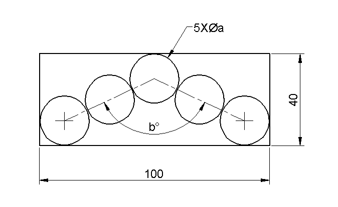

) K( Z' r) |  R& D+ p【进修级练习题3】求:" n' Q4 g# }% e$ X+ l6 d2 }! _
1. a 之直径值为何?9 ^: V6 e/ ?: ]0 j9 d6 ]
    (A) 21.366   (B) 21.636   (C) 21.663% B( B) ~5 u2 q  ]/ k# S
2. b 之角度值为何?* f, n+ P. G9 w
    (A) 129.677°   (B) 129.767°   (C) 129.776°
( f+ |* |% H% P; {& c& r7 k附图:

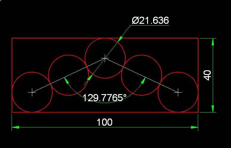

( i3 {) Q# ?9 _, x/ p0 L【进修级练习题3】答案:
. W% S" @7 O7 ^- U1. a 之直径值 = 21.636,就是(B)
8 N* D. E- L$ g* j2. b 之角度值 = 129.776°,就是(C): Y+ k+ l, c/ x) Q
) E# c$ J- ~( ?0 s) e5 W; R8 U' |4 ^1 t  }+ \
【进修级练习题3】动画解题:
: H3 s* Q0 _8 J1 x- r: I$ h+ B如哪位没有Flash播放器,可以到下列地址去下载:
( t! K+ z1 K# i4 ]# ?6 Ahttp://www.3dportal.cn/discuz/viewthread.php?tid=195797&extra=page%3D3" s' n% T1 D$ ~
