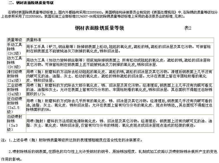

Sa2.5中的2.5只是一个等级
0 z6 J  r. j% P0 h看看附件!
zyxwq + 5 应助
发表于 2007-8-14 10:43:15 | 显示全部楼层 来自: 中国上海
可以参照国家标准:
6 w% |( Z. p* K
0 k9 [9 ~/ u3 G: v/ |0 xGB/T 8923-1988 涂装前钢材表面锈蚀等级和除锈等级
; `% ~; n* p; V0 S  ^" d) Y, j% k$ t! F& K( |$ `" C) f
http://www.3dportal.cn/discuz/vi ... &highlight=8923
wuling + 3 应助

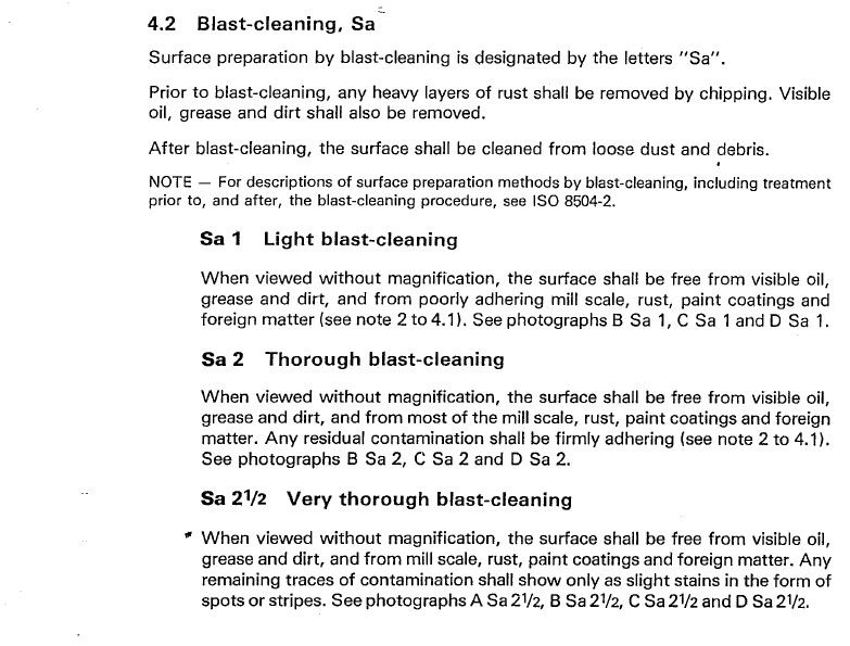

发表于 2007-8-14 11:08:53 | 显示全部楼层 来自: 中国北京
blasted acc. to ISO 8501-1, cleanliness scale Sa 2½.0 h0 O! s4 x; n& B1 r
" O" T* M# b0 B3 Z$ m
ISO 8501-1:1994
  c8 E- E- R: V; D+ J+ F: E$ N+ Y涂料和有关产品使用前钢衬底的制备.表面清洁度的视觉评价.
4 `  R6 K7 ]1 [  q& u; q( a$ t9 Whttp://www.3dportal.cn/discuz/viewthread.php?tid=309855&highlight=8501
, C5 ^5 p% C$ q2 g/ h
( b/ S' `9 A$ J. ^# F/ E+ C- N% ]! N最新版的;1 o# S6 t) Q; J0 [5 J- G6 E
ISO 8501-1:2007 Preparation of steel substrates before application of paints and related products -- Visual assessment of surface cleanliness -- Part 1: Rust grades and preparation grades of uncoated steel substrates and of steel substrates after overall removal of previous coatings1 F+ s2 l; k4 Z5 y& y1 }9 ^8 l, S
http://www.3dportal.cn/discuz/viewthread.php?tid=336910&highlight=8501
zyxwq + 3 应助
