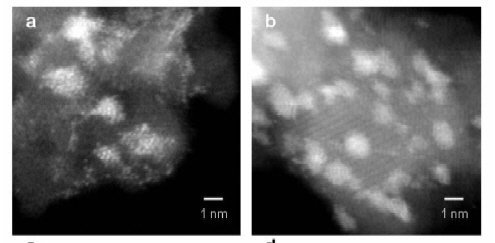

1.jpg % x/ s2 c# T9 w2 ]$ Y
Images of gold clusters. Credit: Phys. Rev. B7 N. S& M' o) ~0 K

, a5 \- s4 i+ E0 W& S' J; dLupini and colleagues employed a special aberration-corrected scanning transmission electron microscope (STEM), which held the record for the highest resolution image until very recently. The researchers were able to obtain images of gold clusters that showed them to be smaller and thinner than previously observed (see figure). They then used an extensive series of first principles calculations to determine the activity of sites with different coordination and how the number of such sites varied with particle size.
