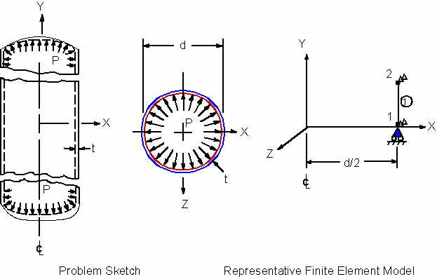

% X4 c, _/ ]; ^+ q$ P标题    Cylindrical Shell Under Pressure
  p( F' z; `& ~) K" c9 W; ]! h( o( ?5 @7 T+ T  m$ [2 [9 W- `! L
Overview
% {9 j" h3 @2 C
9 i1 e8 x6 v, @% v1 m6 U
Reference:
S. Timoshenko, Strength of Material, Part I, Elementary Theory and Problems, 3rd Edition, D. Van Nostrand Co., Inc., New York, NY, 1955, pg. 45, article 11.
A. C. Ugural, S. K. Fenster, Advanced Strength and Applied Elasticity, Elsevier, 1981.
Analysis Type(s):Static Analysis
8 s; i2 b0 G) V/ w& Y) B$ r
Test Case' c) i* F3 P9 W* g& y% S: c
; l! w8 @" j0 H# }/ J
A long cylindrical pressure vessel of mean diameter d and wall thickness t has closed ends and is subjected to an internal pressure P. Determine the axial stress σy and the hoop stress σz in the vessel at the midthickness of the wall.. n4 c6 p, [3 F! Y
5 A5 \0 c9 Z, H- Z# b4 o
Figure 13.1  Cylindrical Shell Problem Sketch
: a# C  n0 C# Q; [, g8 u& V7 v0 F6 p# ~
% B6 ?/ R" {0 {6 J2 t* ^4 E2 ?' ?( O' [: w5 n' M% V) R2 z& X' J
6 h0 i& g: O7 p- y4 D0 h
" X6 N) P2 r, [. Z  I
( d  s/ ?1 j5 W- S
Material Properties
E = 30 x 106 psi
υ = 0.3
Geometric Properties
t = 1 in
d = 120 in
Loading
P = 500 psi
% O4 E) k% Q" O! r/ }" C# u6 N& ?7 N0 r, H* n! y- N% h4 U
Analysis Assumptions and Modeling NotesAn arbitrary axial length of 10 inches is selected. Nodal coupling is used in the radial direction. An axial force of 5654866.8 lb ((Pπd2)/4) is applied to simulate the closed-end effect. / a. W4 K( m8 ?6 N( ~
4 Z* v$ ?% X) M/ O& C8 t
Results Comparison
TargetANSYSRatio
Stressy , psi15,000.15,0001.000
Stressz , psi29,749.29,750.1.000
