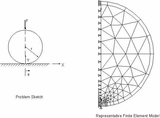

这是我从ANSYS的算法验证文件转换过来的,同样适用于CosmosWorks。在计算实际的工程问题以前应该先计算一个类似的验证文件,比较计算结果以验证自己算法的正确性。也可以作为有限元例题使用。

A sphere of radius r is pressed against a rigid flat plane. Determine the contact radius, a, for a given load F.
# U/ A! j  u( Y; `
% d6 e% ~3 g+ ^$ ~  \Figure 63.1  Static Hertz Problem3 b5 b' ]  R% k1 M, h( R2 u; {+ @5 e

Material Properties
E = 1000 N/mm2
υ = 0.3
Geometric Properties
r = 8 mm
Loading
F = (30 x 2 π) N
1 t( e2 L' B- Z6 ?7 r1 c
) x% b8 @1 Y3 V$ b( g6 f' f$ FAnalysis Assumptions and Modeling NotesAn axisymmetric model is used. A node is placed near the expected radius of contact. Midside nodes are removed along the surface where contact is likely to occur. The model is comprised of both PLANE82 and PLANE2 for verification purposes, but could be solved using either element type alone. The model is solved using 3-D node-to-node contact elements  (CONTA178).
2 o% _) W4 \% z4 R( `" O. h% J: F: N! I$ L- A" ~' {3 L9 X
Results
  Y+ E4 E9 C  u% l1 @: S7 H. N6 K3 P6 I7 K
a, mmTargetANSYSRatio
CONTA1781.0101.0111.001
