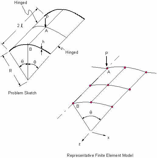

A hinged cylindrical shell is subjected to a vertical point load (P) at its center. Find the vertical displacement (UY) at points A and B for the load of 1000 N.
  J# Q' Q0 I% u, O6 j( \. T2 A+ x0 O! U9 M# @
Figure 17.1  Hinged Shell Problem Sketch
2 t- H( U* R7 W7 }; [. c! U9 S$ E$ l4 b2 b- U. M+ C8 a2 Z# W
VM17_1.jpg " b/ ?* O5 O. m+ i$ v% _  w6 Z

Material Properties
E = 3.10275 kN/mm2
υ = 0.3
Geometric Properties
R = 2540 m
l= 254 m
h = 6.35 m
Θ = 0.1 rad
Loading
P = 1000 N

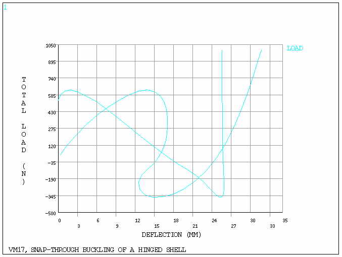

/ p8 ]; U# X3 OAnalysis Assumptions and Modeling NotesDue to symmetry, only a quarter of the structure is analyzed. The structure exhibits the nonlinear postbuckling behavior under the applied load. Therefore, a large deflection analysis is performed using the arc length solution technique. The results are observed in POST26.

  |2 t6 `& B1 v. _0 i7 vResults Comparison
Target [1]ANSYSRatio
UY @ A, mm-30.0-31.71.056
UY @ B, mm-26.0-25.80.994
8 ^6 h& p4 w0 {: C0 ?6 `
  • Target results are from graphical solution
: W% q) ~+ r7 E# K, s2 z
Figure 17.2  Deflection and Total Load Plot/ w* R1 b* T' g# G/ `# d# ]) O
