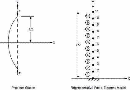

1 z$ W" Z7 {  i! U6 [) ~Determine the critical buckling load of an axially loaded long slender bar of length L with hinged ends. The bar has a cross-sectional height h, and area A.8 n4 I; L2 Y' Y6 G, m# ?, Z4 J
% G+ ~* h! i8 @9 @7 x- S+ y
Figure 127.1  Buckling Bar Problem Sketch

Analysis Assumptions and Modeling NotesOnly the upper half of the bar is modeled because of symmetry. The boundary conditions become free-fixed for the half symmetry model. A total of 10 master degrees of freedom in the X-direction are selected to characterize the buckling mode. The moment of inertia of the bar is calculated as I = Ah2/12 = 0.0052083 in4 .0 g% ^7 }/ N9 D% i; t

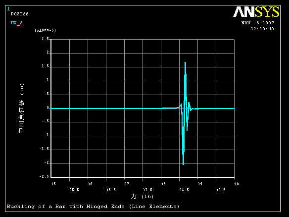

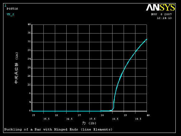

屈曲分析方法分两种:特征值法和非线性分析法。特征值法偏向于纯理论计算,不考虑零件的缺陷和环境影响,所以非线性分析方法更准确。以下方法在杆的中间点加上微小力来模拟零件缺陷或环境影响。一般会比理论计算值低。7 _  `7 B7 e) X# h% Z
0 x/ [' T! t0 S7 E/ a
1. 在杆的中间点加上1e-9 lb 初始扰动的非线性屈曲分析% d+ q/ w+ n$ o6 R, C
0 M- {) o0 S4 d+ A7 A9 `2 N$ K( J

7 i% y( [& M9 v% _7 C' s2. 在杆的中间点加上1e-3 lb 初始扰动的非线性屈曲分析

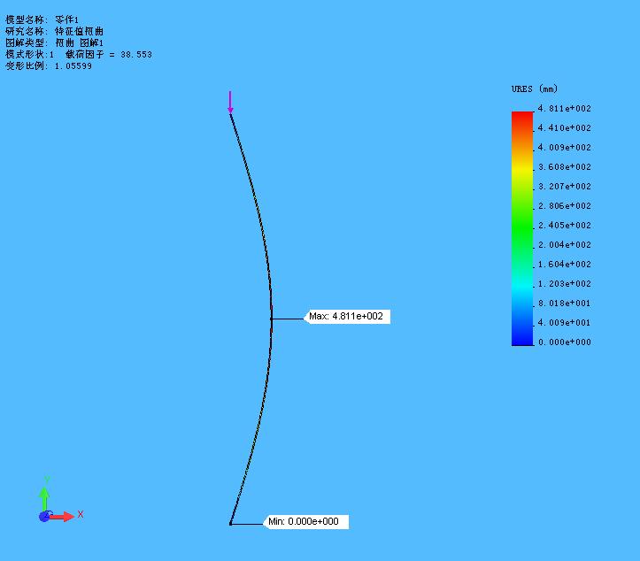

1. 特征值方法,即扭曲研究8 j; S# T( |- w# {1 A
0 U, i3 c' J2 U3 s- X  iLoad=38.553 lb5 Q: t6 L! l0 X- k
( E" q; b2 C/ E3 v! ` 零件1-特征值扭曲-位移-图解1.jpg * X+ d% C1 v" b2 s

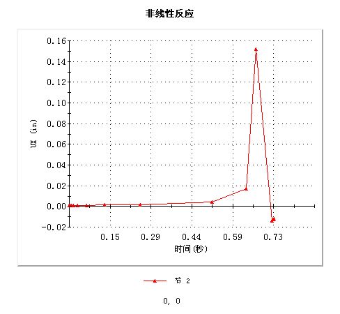

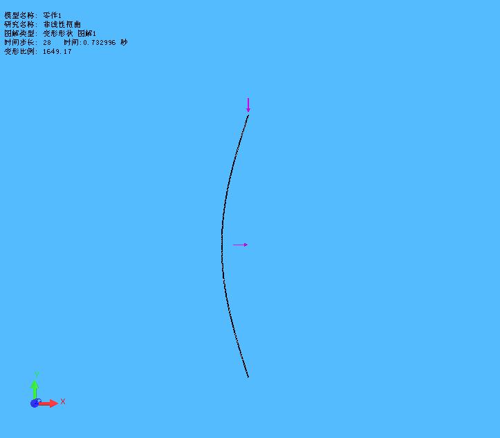

2. 加 FX=0.001 lb 初始扰动的非线性分析,从图中可看到在0.732996秒发生扭曲,此时Load=36.65 lb 1 w3 Y7 K  U4 y7 s! Z1 J
