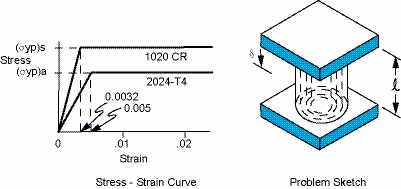

Two coaxial tubes, the inner one of 1020 CR steel and cross-sectional area As, and the outer one of 2024-T4 aluminum alloy and of area Aa, are compressed between heavy, flat end plates, as shown below. Determine the load-deflection curve of the assembly as it is compressed into the plastic region by an axial displacement. Assume that the end plates are so stiff that both tubes are shortened by exactly the same amount.
( F% G* G$ x% P0 M2 K* }2 n! _& z6 ~0 _* @( [. c
Figure 7.1  Pipe Assembly Problem Sketch
2 ], M6 H/ l7 w% \; W0 A
4 N* j" G% l/ x8 t VM7_1.jpg 2 n  c# r* q: G/ z8 Q/ [6 y

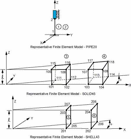

Figure 7.2  Pipe Assembly Finite Element Models$ j3 K/ j3 R0 U& }' }

1st Load Step: δ = 0.032 in
2nd Load Step: δ = 0.05 in
3rd Load Step: δ = 0.10 in

Analysis Assumptions and Modeling NotesThe following tube dimensions, which provide the desired cross-sectional areas, are arbitrarily chosen. Inner (steel) tube: inside radius = 1.9781692 in., wall thickness = 0.5 in. Outer (aluminum) tube: inside radius = 3.5697185 in., wall thickness = 0.5 in.
1 n2 d6 w9 ^' F; U7 r. y, O4 n2 V6 m6 I; ?3 K
The problem can be solved in one of three ways: ' _, x( }0 [- s& A: B
6 O6 ]! |& q( k  q) b
  • using PIPE20 - the plastic straight pipe element
  • using SOLID45 - the 3-D structural solid element
  • using SHELL43 - the 2-D plastic large strain shell element
, w: u; e2 O/ O( mIn the SOLID45 and SHELL43 cases, since the problem is axisymmetric, only a one element  Θ-sector is modeled. A small angle Θ = 6° is arbitrarily chosen to reasonably approximate the circular boundary with straight sided elements. The nodes at the boundaries have the UX (radial) degree of freedom coupled. In the SHELL43 model, the nodes at the boundaries additionally have the ROTY degree of freedom coupled.
  a& z0 I! h/ g6 |+ T# ^An ANSYS warning message is issued stating that element 1, (PIPE20 pipe element) has a radius to thickness ratio less than 5. Because the model involves only axial loading, this does not affect the accuracy of the results.
