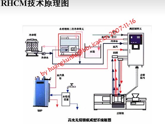

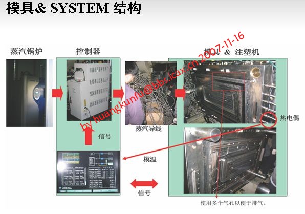

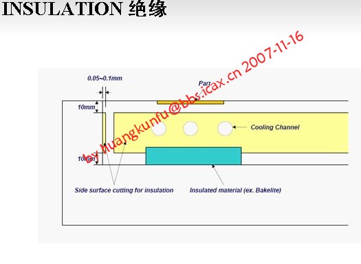

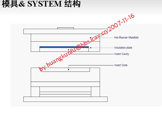

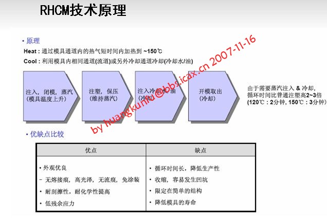

RHCM 模具资料" T4 @, ~8 s+ l: l& O0 P
