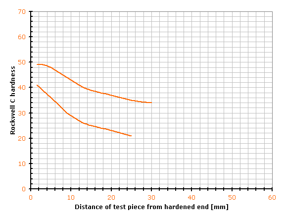

1 h+ `9 w! f( y- F| 材料牌号: | 20CrMnH | | 标准: | GB | | 国家与地区: | China | | 钢组: | 结构钢 | | 次级类别: | GB/T 5216 Structural steels with specified end-quench hardenability requirements | | 注释: | The suffix letter H indicates that hardenability is guaranteed. Based on the smelting quality, the steels are divided into quality alloy steels (no suffix) and high quality alloy steels (suffix -A). | / h/ _$ I* g& A1 ^* n1 s# t7 I
4 g, ?) ?& ^. K- q1 e' T2 A& Q
化学成分 (%)
% u, q8 Z1 M/ \4 }& ^ | http://www.key-to-steel.com/cn/img/nav/spacer.gif! ]! r( l1 }' \
| 元素 | 最小 | 最大 | 近似的 | | C | 0.1700 | 0.2200 |
9 H. \) r% N, j0 e) G' W2 S* L5 V | | Si | & o) h9 [3 B$ I2 Z# C4 O0 {
| 0.3700 | 8 C0 e8 h, v2 N( E
| | Mn | 1.1000 | 1.4000 | $ ^9 x1 N6 o$ D) i" q C
| | P |
8 u2 [6 L& i1 c8 W$ [ | 0.0350 |
# {# ~7 K" r" p+ G; ~% Q( v v | | S |
5 A1 M0 Q8 Q& l4 S, @ | 0.0350 | ! C* Z) e2 M3 X' _1 w3 z8 \# N
| | Cr | 1.0000 | 1.3000 |
0 s' n1 [& X4 C6 k3 F, N- L | | Ni |
# `6 j" y/ b3 t& R8 [7 J2 Z | 0.3000 |
& F9 q$ l) T" \8 w, V" Y | | Cu |
1 b* B% f4 z6 g* d | 0.3000 |
, ] M# M& D9 ^: P) G热处理淬透性
