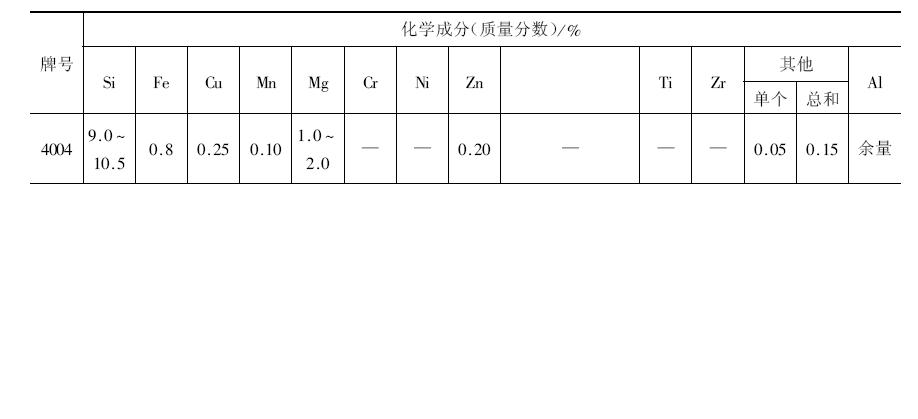

请问德国的GK-AlSi10Mgwa相当于我国的哪种材料?谢谢。8 I" j2 s# _" q+ \0 I% q; o

材料:GK-AlSi10Mg wa
标准:DIN
国家与地区:Germany
金属类别:Aluminium Alloy
次级类别:DIN 1725-2 Aluminium alloys, casting alloys
注释:Sand casting, gravity die casting, pressure die casting, investment casting; Replaced by DIN EN 1706

化学成分 (%)% r! g, m% {+ O# {: z
http://www.key-to-nonferrous.com/cn/img/nav/spacer.gif( I/ M  r6 F# _+ d- Y
元素最小最大近似的
Si 9.0000 11.0000
Cu 0.0500
Mn 0.4000
Mg 0.2000 0.5000
Zn 0.1000

Fe 0.5000

材料属性 8 q! X) S$ W2 g' P+ m
http://www.key-to-nonferrous.com/cn/img/nav/spacer.gif4 [5 Q4 J4 @4 `& x8 f/ b8 I
  Min.Max.Approx.
Solution heat treated and artificially aged (w.a.) ; Permanent mold castings
Yield Stress, Rp0,2 (MPa):  210280
Tensile Stress, Rm (MPa):  240320
Elongation, A (%):  14
Hardness:  85-115 HB
. v" S, P/ U$ k! Y2 Y, i

发表于 2007-12-25 11:32:09 | 显示全部楼层 来自: 中国福建泉州
查了工具书,有两个相近的:6 O% W6 r- c. e9 Q$ U. i
1.GK--AlSi7Mgwa----相当于国内牌号:ZL101; T5 m6 X4 B+ |! q+ V: \3 c
2.GK-AlSi10Mg-------相当于国内牌号:ZL104
mideas + 2 应助
