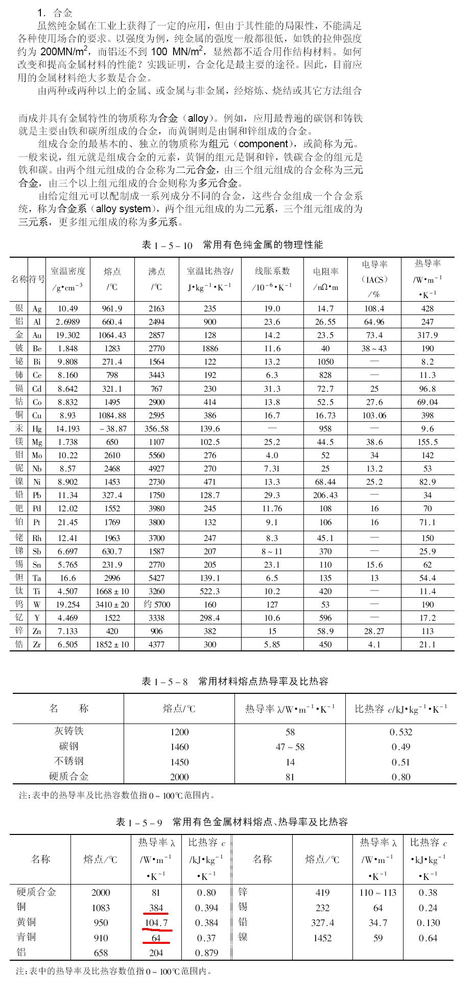

5.JPG ' _- d& w. Q: ~1 _: `: k& i* F. W
例如:
  N* }: y/ b8 W6 [, Mhttp://www.3dportal.cn/discuz/attachments/month_0712/20071224_07f254d7e4651597dd2dPncjgjmRVRtS.jpg
* L% g* r. O6 p. z- j9 Z- Y. u$ M/ i  C7 H0 p, m1 T4 s
http://www.3dportal.cn/discuz/viewthread.php?tid=420596&page=1#pid1930714
