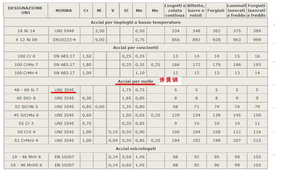

50 CrV 4 对应 50CrVA2 l( p# S8 T9 o# N% X3 R7 ^6 z
材料牌号:50 CrV 4
标准:DIN
国家与地区:Germany
钢组:结构钢
次级类别:DIN 1652-4 Bright steels for quenching and tempering
注释:Technical delivery conditions; DIN 1652-4 was superseded by EN 10277-5
用途:Permanently stressed machine, engine and vehicle parts when high strength and toughness are required. Most severely stressed springs for trucks, torsion springs.

意大利标准UNI 3545:1980
http://webstore.uni.com/unistore/images/generic/transparent.gif
Prodotti finiti laminati a caldo in barre e vergella di acciaio legato speciale per molle bonificate. Qualità, prescrizioni e prove.
' h9 H1 p9 }4 ]8 L+ p: y/ h关于:成品热轧棒及合金钢线材专用弹簧。质量,规格及测试。9 w% c( S8 E: g# E

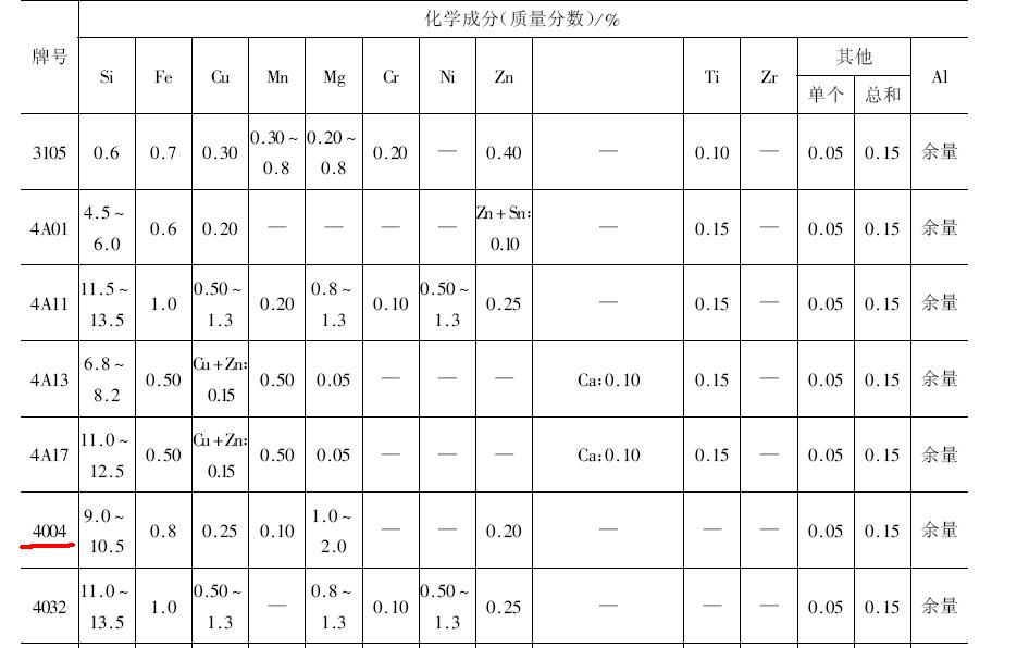

GJS400/12 UNIEN1563
/ V% Q$ I+ F! H' W! `5 N$ V( C" L+ z; P, V" E; a0 k
UNI EN 1563
( r- U2 L; I+ M7 U. ^; u) F/ A' [4 v# WFounding - spheroidal graphite cast irons (意大利标准)球墨铸铁
+ b6 `0 q; U9 i2 k
G AlSi9MnMg 对应4004( G+ l5 J' ]; g& G. g
材料:G AlSi9MnMg
标准:UNI
国家与地区:Italy
金属类别:Aluminium Alloy 铝合金
次级类别:UNI 3051 Primary Mg-Mn-Si- Al alloy for casting (Si 9% - Mn 0.5% - Mg 0.35%)

Si 8.5000 9.5000
* a9 E+ g' O4 r7 i
Cu
+ h/ n, v( w0 Q2 L- i, x
0.1000 7 p& V8 |! r" [. `
Mn 0.4000 0.6000 2 W1 n% ?# Q2 L' c! n6 y
Mg 0.3000 0.4500 ; @% u9 R1 H2 K# i, F+ X+ t8 N0 S2 X
Zn
$ c; b9 b8 \4 R9 r" y+ c8 B
0.1000
( U: _0 {* Z, k3 _9 g4 O
Ni ; [) U) ~# ]7 {/ E1 D
0.2000
3 \% N/ c. B$ t% O1 Y6 R: o
Ti
' ?( P3 i8 d( _$ @# K1 w, C
0.1500
, u) q% e, B' V( j
Al (*) 7 H  T& `- k3 c
$ n% R4 B% m  \* Q+ w. X
: I% l, ]  g  j
Fe
, J% J% ~) ^) t: h6 u
0.7000 : Y% w( ^, H, u5 q" E4 [
2 p; V! b, k  F" ]; u' H4 Z0 s7 Q' Uhttp://www.key-to-nonferrous.com/cn/img/nav/spacer.gif0 ?$ A4 `! N) B
元素注释
Al Remainder
  d4 o4 F2 g7 n4 N/ }& ?7 w% i3 z! Y
