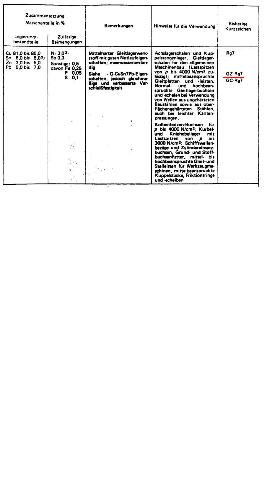

请教一下,ms是德国的一种铜相关的材料,牌号是gz-rg7,哪位知道吗?谢谢了
发表于 2008-1-9 13:33:11 | 显示全部楼层 来自: 中国安徽芜湖
Gz-Rg7  德国材料
' U) A5 J% n* F3 u) ?) R  a9 nDIN 1705 Copper-tin and copper-tin-zinc casting alloys (Cast tin bronze and gunmetal); Castings0 A9 B0 H9 q4 @0 x; I! }
材料:G-CuSn 7 ZnPb
标准:DIN
国家与地区:Germany
金属类别:Copper Alloy
次级类别:DIN 1705 Copper-tin and copper-tin-zinc casting alloys (Cast tin bronze and gunmetal); Castings
注释:Replaced by DIN EN 1982

元素最小最大近似的
Cu 81.0000 85.0000
: H& v4 k5 S0 z+ d/ K* T5 r1 s
Zn 3.0000 5.0000 7 r! I0 c) ^5 q) B& q, q
Ni ( u3 {. p  V" ^5 I8 Y. y- m
2.0000
% k$ Y& o$ ]/ F
Fe : _, c1 n( c% I- L' k' U- o$ m* c. {
0.2500
7 f8 G5 G( ~# E5 W8 w5 ^
Pb 5.0000 7.0000
3 Y7 Y6 A; |# l) L" j9 ]
Sb
, I1 w! K4 l, s3 I9 E' }
0.3000
6 k% ^" n5 C, [- f
Sn 6.0000 8.0000
- e- [, r$ T; |6 ~$ Z% [7 h
P / S6 y' l& v7 ~$ R$ H3 ?' Z$ d
0.0500 1 g" Q$ Z3 n: g6 l
Tot. other 3 |) M/ S7 f4 t3 W/ g  f
0.5000 7 F& R' _$ j: D4 v
S
+ p* Q7 Z% C) a6 F9 j' u, F
0.1000
Click on hyperlinks to review details about mechanical properties., ]  V% a, R; a+ y) E5 g2 i
& z5 j: E2 n" A) q
http://www.key-to-nonferrous.com/cn/img/nav/spacer.gif6 a+ Y. P( [3 @" K! M. f- {' r3 k) S
) _8 D/ f3 j% M4 e  @

  Min.Max.Approx.
Sand castings
Yield Stress, Rp0,2 (MPa):  120
Tensile Stress, Rm (MPa):  240
Elongation, A (%):  15
Hardness:  >65 HB
E (MPa):  98115
S (MPa):  180192
  A) C) X8 l* r6 A2 U
# q" C+ ^2 C  B$ r
7.JPG 1 ]2 N4 D! ~0 Z( W

Gz-Rg7:
# N& r6 D& b7 x* A& r  Q9 K遵循DIN1705
7 p* B2 t- j- s# b: n抗张强度:30 -32 ( kp/mm2)! o( e' B+ S: r4 O! J* |% Z  t* l
断裂延展:20 -25(S0)
; U. z, s2 L7 g+ C5 q布氏硬度:HB85- 95
ajhtiger + 3 应助
