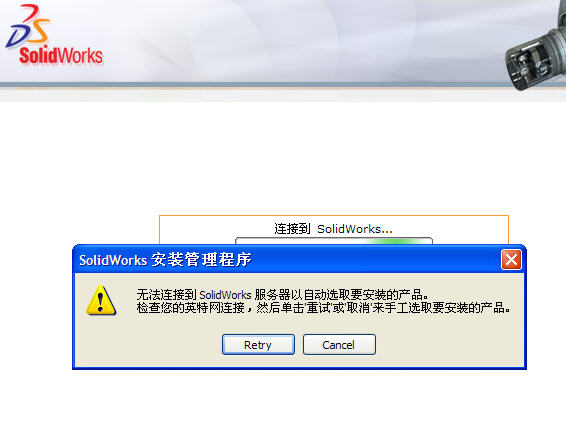

你的问题可能出在安装序号上, 试一下0101 0000 1289 1488 R4H5 Q533, 并断掉网线, 当出现下图时选择cancel. 而后往下走.

Guys!1 b+ V8 ^( g1 t) Z9 {: N" ]
All you make a big mistake then allow to Install SolidWorks2008 using automatic SolidWorks Installation Manager (it is new feature in SW2008)
9 I& F5 A# a  y+ }SolidWorks Installation Manager checks you SW-Serial and allow to install only that SW2008 configuration that registered for that SW-Serial..
3 |* m3 r9 d  I, x) |8 p$ m. E" l4 ~
It is funny but if you use a valid but not registered SW-Serial you will be allowed to install all you want manualy!9 I) S0 b5 V- f' _& f7 @6 s
* e( u7 T3 N. f7 \- d
So the right way to inatall SW2008 is:/ E; w  Z: |7 I0 X
1) Interrupt and Cancel SolidWorks Installation Manager working$ Q' m* F9 A0 ^4 u
2) Browse to E:\swwi\swsetup.exe (E: is a image of SW2008 SP0.0 5,4 GB ) and run it
2 H$ d& R& l5 C1 x9 J; a3 K3 k  ^# f5 r* v: w
So you can be able to install all SW2008 configurations ( as it was in SW2007)

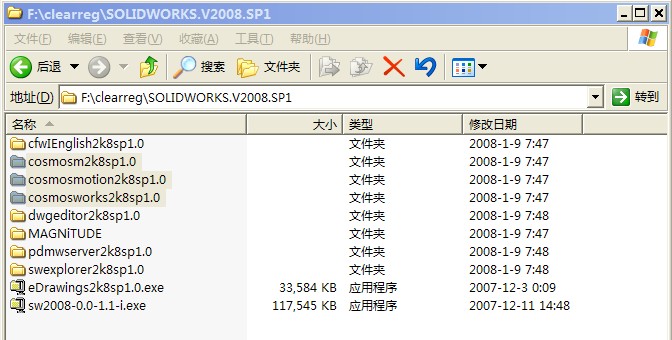

发表于 2008-1-10 15:56:11 | 显示全部楼层 来自: 中国浙江温州
下载了SP1.0的集成包,里面有各种插件的SP1.0版,不需要原版的即可升级到最新。
