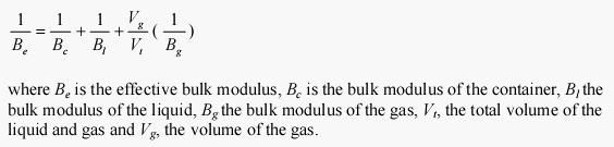

发表于 2008-3-4 12:29:48 | 显示全部楼层 来自: 加拿大
I don't have chinese input software. so have to use english. excuse me
β is the bulk modulus
. @* y( N" q/ X6 ithere are several ways to find β.
2 G! y* T% V. ~but normally, in hydraulics, we use effective bulk mudulus, @, N' S& Z0 L4 G$ |+ W
+ |# i  U& X' P9 f! l9 |% R/ ^# b
usually, when we face this kind of situation.* G6 Y$ ]9 a: X! V1 J- _
it is better treat the system as a whole./ |# _) \, m* Y- X7 I% I  b
please see the following figure3 B; A" R2 r* T, \* l9 ]9 _% L, l+ B
2 ]5 ~: i7 [( L! q4 O

我觉得压力飞升速率,除了考虑泵的流量,油的弹性模量,密闭油的体积外,还要考虑容器的弹性。公式的推导纯粹就是数学技巧。
