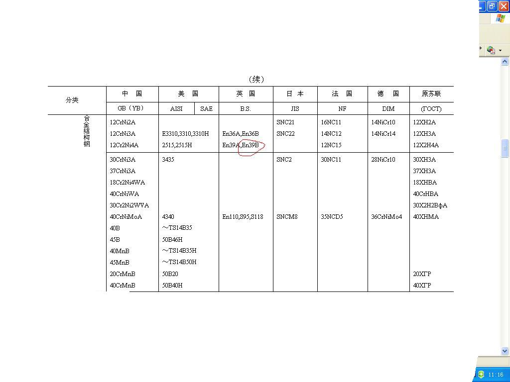

EN39B是哪国的牌号?

发表于 2008-3-22 08:12:28 | 显示全部楼层 来自: 中国北京
EN (英国)的牌号
Material: En39B
标准:  B.S.
国家与地区:  United Kingdom

发表于 2008-3-22 12:27:27 | 显示全部楼层 来自: 中国浙江绍兴
请看这个是否有用.

英國標准% n  [1 n  p0 }
EN39B Case hardening steel
& u! c% {/ C) j' x/ S! A                          C      Si     Mn Ni     Cr    Mo    S         P
$ ~+ r3 h5 R1 M2 v1 c/ X9 @3 l(Ave. values %) 0.15 0.25 0.4   4.2  1.2    0.25  0.025 0.025: b2 F  r' G0 j& _1 c
                      AS            DIN             BS
: c# l4 h9 l8 l+ |7 u8 ^NEAREST
/ Y/ n$ l( c6 ^STANDARD X9315     1.6723         835 M 154 [8 L6 b% i$ Y4 o6 _
! q% H4 Y/ o, J. q! b
DESCRIPTION 1 R4 S1 C* ]3 }( b
    4¼% Nickel Chromium Molybdenum case hardening steel for large and highly
/ a5 ]" Z6 P6 y/ x3 Ustressed applications.
+ a; y" X% S+ W( H8 A& y# W) n& B
APPLICATIONS
9 ^; }6 g9 {5 u) K1 B1 e9 t# [8 g    Components with large cross sections requiring very high toughness and core strength (1300 MPa) such as gears, gear shafts and heavy duty gear shafts in aircraft, truck construction and mechanical engineering.
; O) s/ r2 u- [* [2 z5 q3 e/ h
4 D, b. c$ n6 j0 c& [. W7 b, AMECHANICAL PROPERTIES Heat Treated Condition. p; e; E0 \0 G( J# c- ]; W
Tensile Strength MPa  1310' s. q& N* F7 `$ ]5 f. M/ a- F
Elong.%                       12: e( d" N$ d1 f
Izod Impact J                33" h6 U2 G3 J, B% b1 c
Brinell Hardness Annealed  277max
: ^( d4 f, [3 q1 c
1 a$ C  b/ |- Z* z5 r! u& ?HEAT TREATMENT
. t5 n4 ]. |, r- PForge                850-1050oC. Cool in furnace." L" g3 t, L: x& C
Normalize        850-880oC. Air cool.* i, F- I4 d  h
Anneal             650-700oC. Cool slowly in controlled furnace.
! E4 p+ B; c" g) k' V6 m! SCarburize          880-930oC. Furnace or Air cool
# E, F4 t: q8 g. ?Core Refine        850-880oC. Oil quench or Air cool.' ~8 a# g" F1 W4 r/ \3 _
Harden              760-780oC Oil quench.
# C5 k. h5 C* g1 K3 Y& MTemper            180-200oC air cool
! w# d0 f6 L6 n. E. M- z2 u
. Z8 c% Q% q8 l; {* \WELDING
4 a; A) j7 ?5 Z  @7 x        Parts should be welded before Carburizing and Hardening. Preheat to 250-350oC.1 Q2 l  B$ I! o4 ]+ d
        Filler metals:-Bohler FOX DCMS-KB or FOX 2.5 Ni electrodes. DCMS-IG wire.
; `. s) A4 H' }8 _  n9 ^  Y: c! J( x) ]4 J
SIZE  RANGE 2 s* a6 S+ H* o8 b2 N0 B+ B# _* Z
Round 42-142 mm

英国的标准,EN是欧洲标准European的简写。
