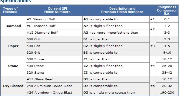

客户要求Polish S.P.I C3,不过我们生产单位无对应标准
9 O3 z! m0 ]) E: Q3 j" @$ M  Z1 m请教大家
( y: @  E) v; ^* p4 B, @- Q. N) f3 @5 X
抛光 Polish S.P.I 标准的C3所对应的粗糙度是多少?

等同于320号油石抛光效果,具体粗糙度不大清楚。

就是表面光洁度的美国一个标准,如果是钢料的话我就是知道用320号的油石经过加工得到的效果,平均Ra u-in 38-42 SPI-C1 (600 Stone)5 U4 n1 C! `- t( J: `- S
SPI-B1 (600 Paper)
5 B' H4 P$ [8 F$ n5 R  eSPI-A2(High polish)

NOMENCLATURE
! y  l  s. h- p! [
! j( L: ~: i: \
* w: f( ?: H: a' M4 t! |% sSPI Finish A-1 -- Grade #3, 6000 Grit Diamond Buff( {' z0 H" r. }1 _8 {- i
0 u9 ^- Y; d9 j  zSPI Finish A-2 -- Grade #6, 3000 Grit Diamond Buff
) F1 v$ _; v5 @. h# L
  Y* G9 ~3 v# k" [* GSPI Finish A-3 -- Grade #15, 1200 Grit Diamond Buff 2 @2 u' y: V* W' g
, s( \+ t9 ?4 d7 V1 Z( m1 \
SPI Finish B-1 -- 600 Grit Paper7 E1 E4 b* q& c- h$ R# q5 S4 H) P
8 ]9 w. `& |" e, w4 |SPI Finish B-2 -- 400 Grit Paper* J! A! Q& y3 x: E- [% z0 [8 c1 Y  e
) z9 ^" j1 Q+ E1 v$ p  r1 J
SPI Finish B-3 -- 320 Grit Paper
1 A6 L; B0 X# @6 T7 [  j! A
( V6 N- n( g% l% z. [SPI Finish C-1 -- 600 Grit Stone9 G7 P& ~! d; u6 {3 d
) D7 G: G% U$ D4 j, I. f" D
SPI Finish C-2 -- 400 Grit Stone
: ~5 e. [$ i( @7 _
6 n! a  O# u; Y! S' ]/ cSPI Finish C-3 -- 320 Grit Stone# {  v; I# x7 j& b2 I4 Y
6 J' u& M( s( \# U% Y, ~SPI Finish D-1 -- 600 Stone Prior to Dry Blast Glass Bead #11) u3 W" f0 N3 d
5 G( p1 n1 \+ H4 `
SPI Finish D-2 -- 400 Stone Prior to Dry Blast #240 Oxide
' h4 d' E% I" P* Q, B3 l* t
# v( s$ {8 i2 ]; d  KSPI Finish D-3 -- 320 Stone Prior to Dry Blast #24 Oxide
9 ~- L+ ~5 H; I3 [8 v& [% ^4 c# |8 W5 P* y$ ~0 h/ S# t( z+ q
SPE -- The Society of Plastic Engineers
+ C/ r2 k( ?$ w5 Y2 I/ A7 x3 t) f0 i0 V9 D5 X, Z1 Q8 _
SPI -- The Society of the Plastic Industry
) T$ [; i1 d0 O. Y; V0 D: K  G4 B2 n
[ 本帖最后由 mideas 于 2008-5-19 15:46 编辑 ]
