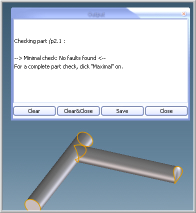

attached file is the one i gathered from my corrupt part. the computer said, edge short. is there anybody can help me out. thanks!

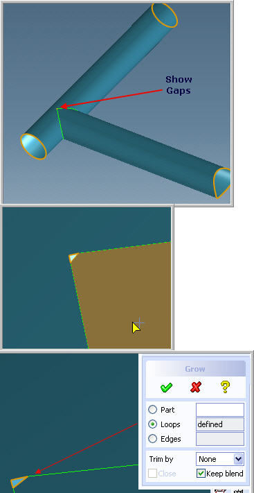

其实还没有完,用Insert来补面,Flip Face来翻转法向,Checkpart后发现短边,用补面的手法将相应的位置cut掉就可以了。
