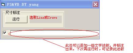

[分享] 针对鞋模卡板线长度的尺寸标注的VB(附原代码)
发表于 2008-11-30 15:06:26 | 显示全部楼层 |阅读模式 来自: 中国广东东莞
针对鞋模卡板线长度的尺寸标注的VB8 Z* n" W7 B2 \
本来想做个GIF,但家里的电脑没有装PS。
  p. ~* \0 o# B. u! Z* F使用后有什么问题。请提出改进
5 a* C( `" r" M5 a7 Z& I) a ps(标注尺寸)v3.0.rar (6.96 KB, 下载次数: 45)

也来学习版主的分享精神,分享一下这个VB的代码
3 G& s( A1 x( r- U( o   PSHAPE.Execute " Create datum"3 Y; F6 n. l: U, E% Q  d
   PSHAPE.Execute "NORMALSINGLE"
: L$ e6 b/ ]6 t6 W  W& \: C+ V3 x   PSHAPE.Execute "create workplane SINGLE"7 k; c+ G9 b1 m3 r" k6 N
   PSHAPE.Execute "0 0 0"4 P9 t3 b9 j& s6 d6 u
   PSHAPE.Execute "ACCEPT"
1 K) M8 p+ b+ u# ~2 `   PSHAPE.Execute "MODIFY"
( Z# u9 G; m8 \: _4 `" U) Z% J   PSHAPE.Execute "NAME temp"
7 y) Z2 M6 a% M8 n4 h, ]( H7 `   PSHAPE.Execute "VIEWALIGN"/ r8 Z7 e7 o6 L/ U; u
   PSHAPE.Execute "ACCEPT"; t% k; O. j) t8 N3 h
   Label1.Caption = "选取了" & Format(SelCount) & "条Line和Cruve"
: c4 u- i2 m9 d  W2 x" W& X    PSHAPE.Execute "SELECT CLEARLIST"4 ^$ q5 [: R. `1 z$ s' d, k
    For I = 1 To SelCount
1 |/ X; W. D# y9 W        L = PSHAPE.Evaluate(SelTypes(I) & "[" & SelNames(I) & "].length" )
8 g' s# Q& ]# X6 S+ k        Xstart = PSHAPE.Evaluate(SelTypes(I) & "[" & SelNames(I) & "].start.x" )
& D- l% B6 P) b5 F* e9 D! [        Ystart = PSHAPE.Evaluate(SelTypes(I) & "[" & SelNames(I) & "].start.y" )
) F) }8 Z6 g: s' c2 ~        Xend = PSHAPE.Evaluate(SelTypes(I) & "[" & SelNames(I) & "].end.x" )4 S3 a9 I5 I" c& b" I' U- j# v
        Yend = PSHAPE.Evaluate(SelTypes(I) & "[" & SelNames(I) & "].end.y" )4 U$ e2 @; B2 j3 h7 y" F
        If Xstart = Xend Then) e  |' t8 m) j3 M! \
           If Ystart < Yend Then2 n0 a3 s, G* l) B3 c  e1 i
              PSHAPE.Execute "ADD " & SelTypes(I) & " '" & SelNames(I) & "'"3 ^4 B2 t/ W0 ?; e7 p
              PSHAPE.Execute "modify"
5 S9 d2 |3 G- V! z& X              PSHAPE.Execute "reverse"
  S9 h! R- J+ x  E5 h7 ]5 N  ~- L              PSHAPE.Execute "accept"; Y4 E( Z+ \; [
              Ystart1 = Yend: Yend = Ystart: Ystart = Ystart18 ?9 ^$ S) ]$ ?& G& [
           End If
" \) g  L: f4 y# X' u* O0 a           D = -90( h/ D9 F1 o) B2 `' |" ]/ h- x
        ElseIf Ystart = Yend Then+ f1 D6 t5 p) n8 V  i9 e
           If Xstart > Xend Then  ]) |1 v7 o, O: x! M' b( a: |
              PSHAPE.Execute "ADD " & SelTypes(I) & " '" & SelNames(I) & "'"8 b, S6 l% @5 [+ K9 v0 l" M  r( g) ~
              PSHAPE.Execute "modify"# w% Q3 T/ t! D: V: q, V& c/ r" z5 u
              PSHAPE.Execute "reverse", \. v( t5 L3 ]1 d6 M. e
$ |" I. u! g! X5 ^. Y              xstart1 = Xend: Xend = Xstart: Xstart = xstart1: A. [- `  u9 K9 R# L4 a& a
           End If
7 n( O2 D! }' U5 R           D = 02 g8 r" D0 U) p9 d& s4 S$ w3 S9 y
         Else
; J5 ]6 j7 }% S1 l! H# ^          D = PSHAPE.Evaluate("atan(" & Format((Ystart - Yend) / (Xstart - Xend)) & " )" )
# p; f# {# U8 g6 v, W' Q           If Ystart < Yend Then
3 r2 h# n# _3 J6 G/ a+ X; S6 a1 j           PSHAPE.Execute "ADD " & SelTypes(I) & " '" & SelNames(I) & "'"' o0 e& m! a; X+ o* O
3 f" c3 s/ C+ t$ d3 P! @           PSHAPE.Execute "reverse"+ {# H# C) \2 y. f: z- P1 Y
. `  `' o% z3 P( g( P5 [           xstart1 = Xend: Xend = Xstart: Xstart = xstart1: Ystart1 = Yend: Yend = Ystart: Ystart = Ystart10 H( g1 m- o, g* L# P
            End If
2 [* S6 A* ]0 e         If D >= 50 Or D >= -50 Then
$ W8 |; A! g- p' n4 @         D = D - 180; C5 y6 ~; }6 r1 i/ L
        End If5 P2 ?: L0 H9 l* K
     End If
$ Z0 C& }3 ^# {" s! o- @8 U4 l( [        n = (Int(L * 100 + 0.05)) / 100
) T/ i4 d* Q( x9 ~4 i) J1 q        PSHAPE.Execute "Create ANNOTATION") R4 v3 j! _+ E% l5 Z, F9 l
        PSHAPE.Execute "CREATE TEXT TEXT HORIZONTAL YES"$ m: b4 n; c$ k& B. w
        PSHAPE.Execute "TEXT FONT Delcam Sans Serif"& _/ m( K1 _% `; f. h: m8 c
        PSHAPE.Execute "TEXT HEIGHT 5"
* R( O6 x1 D$ c9 _        PSHAPE.Execute "TEXT ANGLE " & Format(D)) R4 E, T9 m' Y# b/ u9 F
        PSHAPE.Execute "ABS " & Format(Xstart + 2) & " " & Format(Ystart + 2)
% |0 P% G% M; U' ~9 q- r        PSHAPE.Execute "ScrolledText " & Format(n)6 w7 L& c1 U# T4 P; F
        PSHAPE.Execute "ACCEPT"  j, n8 `5 F& c! d6 F- @
: \4 X" t' E& B# Z" g1 v- C        Next I
2 k; c& Z* T, |7 v% Q# `* k3 oIf Check1.Value = 1 Then  I) R. m1 G9 K, O/ |; |' z* O: f
PSHAPE.Execute "Create ANNOTATION"3 F4 d5 ^5 t* c; v
PSHAPE.Execute "CREATE TEXT TEXT HORIZONTAL YES"$ w2 p2 ?. B% \: |1 c
+ |/ x: T" E* M( s" z* f$ M9 LPSHAPE.Execute "TEXT HEIGHT 5", H1 d# ~8 f) Z( ]
PSHAPE.Execute "TEXT ANGLE 90"
. C; K. _+ h* v1 F! g- A- ^6 GPSHAPE.Execute "ABS 0 0 0"
: l( g. B( B$ n% M1 J# ?; m0 ~: NPSHAPE.Execute "ScrolledText " & Format(Text1.Text)& c8 D, @3 U$ g- j' n/ t+ X
PSHAPE.Execute " TEXT ORIGIN BOTTOMCENTRE"
% P3 B* N% V" s6 g' n% T% aPSHAPE.Execute "ACCEPT"* B5 K, Z/ F& O% O
PSHAPE.Execute "SELECT CLEARLIST"3 z2 l$ R. p( E0 H, [
End If
* v0 Q5 C! F1 _3 w' ]7 dPSHAPE.Execute "add Workplane 'temp'"
% a! [3 v" g  }+ \9 cPSHAPE.Execute "Delete"
5 |" r& z. ]( u& Z" ROpen App.Path & "\1.txt" For Output As #1" |. c4 Q' o4 }+ Z% r' ?
Print #1, Text1.Text
4 P9 _3 i# L+ l. L, }0 p  F& kClose #1
( E+ d$ r3 e' ?; u# m' X' K见笑了!

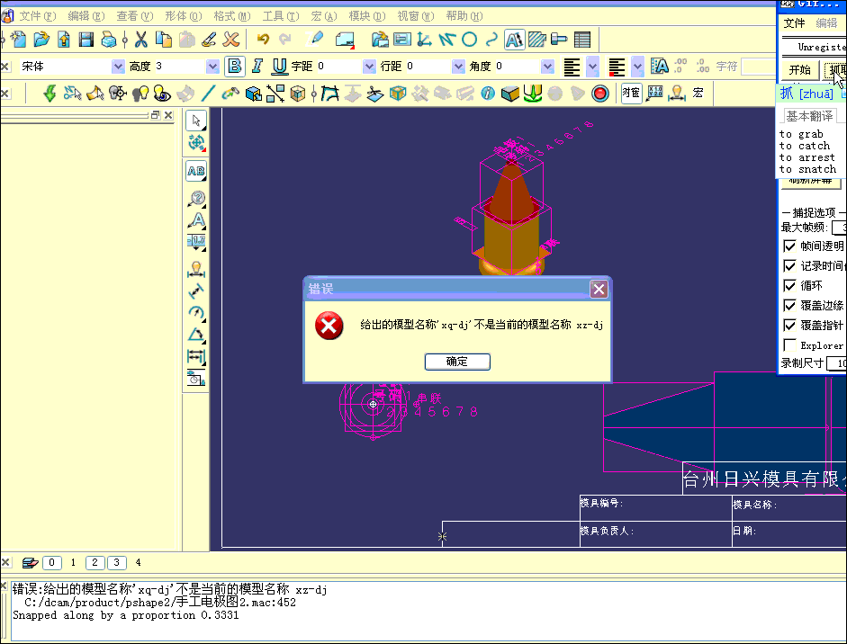

楼主>多谢你的成果.我想问一下ps,取消错误警告的命令是?
发表于 2009-1-5 16:48:49 | 显示全部楼层 来自: 中国浙江台州
请看图
 楼主| 发表于 2009-1-5 17:47:20 | 显示全部楼层 来自: 中国广东东莞
dialog off
