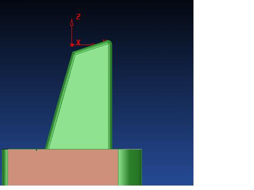

Dim XMAX, XMIN, YMAX, YMIN, ZMAX As Long) G2 v* Q, ]+ _: s; {
2 Z( |2 k' Y0 {: t8 `+ h  N, ~
PowerMILL31.Connect
" A) i$ V2 G& k% l' o$ w; O
: ?/ g6 K# b. _6 h3 A# APowerMILL31.Execute ("Form BLOCK")9 W3 k9 x  Q- `  j! g$ F) ]) s
, M9 t6 o* A$ Y4 \0 y& }* Z
PowerMILL31.Execute ("EDIT BLOCK ALL UNLOCK")
/ q' }. @$ \! U" C5 f, `1 X! l3 K- g# T' ?
PowerMILL31.Execute ("EDIT BLOCK TOLERANCE 0.1")
' w2 T/ V+ \: L, S
' W0 I5 j/ w9 `' J; j1 lPowerMILL31.Execute ("EDIT BLOCK RESETLIMIT 0.")
% t, A% {2 r( u" s! }6 a0 ]1 I5 ^' Z# H% e" E* `5 r. t: \
PowerMILL31.Execute ("EDIT BLOCK RESET")
  a- S2 z' d( x7 A+ `0 K. I
! v% q' k1 t( E) o6 ^PowerMILL31.Execute ("BLOCK ACCEPT")9 o" y$ r1 E; w; A- p0 C
5 x' L! F' t+ B+ }( f3 `/ Y0 m
ZMAX = PowerMILL31.ExecuteEx("PRINT FORMVALUE RoughBlock.LimitFrame.MaxZ")
( l' }0 n2 d6 f( `" s! `
% m! R8 _/ R8 w0 }! Y7 x( F% P/ E5 bXMAX = PowerMILL31.ExecuteEx("PRINT FORMVALUE RoughBlock.LimitFrame.MaxX")
  Y& r' \, l- q0 D3 e% M$ s/ k
6 t8 J9 O# x! a1 D1 J  H- }XMIN = PowerMILL31.ExecuteEx("PRINT FORMVALUE RoughBlock.LimitFrame.MinX")
/ S" }6 b8 X2 Q( l
' H) \* j. E+ i% h6 {7 UYMAX = PowerMILL31.ExecuteEx("PRINT FORMVALUE RoughBlock.LimitFrame.MaxY")
1 w8 Z2 ~# m# W1 [2 ^  r$ c3 [1 ^/ ~
YMIN = PowerMILL31.ExecuteEx("PRINT FORMVALUE RoughBlock.LimitFrame.MinY")
( g( {1 Y0 `. {; r' |9 ~6 P9 @' Q9 t' }3 l+ t
PowerMILL31.Execute ("TRANSFORM RESET TRANSFORM TYPE MOVE TRANSFORM MOVEX  " + CStr(-(XMAX - (XMAX - XMIN) / 2)))2 H: O* y6 t. v9 B
( d7 Z  E# B( Q- IPowerMILL31.Disconnect+ U) k1 ?# q7 A: M
. f9 S6 y9 x! N! k
End Sub2 S* ^: g: A+ p; J
% ~: o" m. g* N5 ^+ M* e# f; jPrivate Sub Form_Load()
* q, w0 L3 W, Q; @' ^) B6 H8 b3 @5 l( t( l! m- O6 i0 R
PowerMILL31.Connect psStartPowerMILL
; m8 O$ P* \% }" x. R2 x9 l0 g% R- k& S, ^0 {+ d6 a
End Sub

我把Z轴设在最高点。是这样编的,可是移不到位呀。。还请帮助解决。
; t# r# q  H; A% c2 ]7 a
  Z% v, }4 ]* B8 k, i: sDim ZMAX As Long
' l3 I! I1 o$ \; D- OPowerMILL31.Connect: g8 V8 J- g1 T
/ D! U  L% [" O* Y0 i0 DPowerMILL31.Execute ("TRANSFORM RESET TRANSFORM TYPE MOVE TRANSFORM MOVEZ   " + CStr(-ZMAX))8 X5 w+ v: R$ }- ^2 h1 R
PowerMILL31.Execute ("TRANSFORM MODEL ALL")8 L4 N1 H1 f- j/ d
8 u2 C# ~- |) G. ?, d8 M9 j8 ]5 v$ L4 S7 J
Z轴不在最高点呀,有时候还高出最高点。是什么原因,是不是因为long是长整形数值呀。。。
 楼主| 发表于 2009-1-4 18:54:33 | 显示全部楼层 来自: 中国山东烟台
Z轴移不到位的问题,本人已经自己解决了,原来是变量高错了。我试了一下把long(长整型)改为double(双精度型)。然后就OK了。; v* I# Z! O+ [- q1 `2 b

发表于 2010-6-19 04:22:29 | 显示全部楼层 来自: 中国广东深圳
整长是四舍五入的,最好不要用,要是遇到镶件是小数的,可能移不到中心。你这个代码最好在后面加个判断如果Y方向大于X方向。那么工件沿Z轴转90度
发表于 2010-6-19 05:06:25 | 显示全部楼层 来自: 中国广东江门
这个不是自动建立坐标的命令啊
发表于 2010-6-21 12:40:39 | 显示全部楼层 来自: 中国海南海口
把long改为Single就行了。就是整和小的问题了。。
发表于 2010-6-22 00:50:22 | 显示全部楼层 来自: 中国广东深圳
呵呵,以前学着看王大师的代码时,就发现这个问题了,铜公长宽一般都是整数还好,高度不是整数就出问题了
