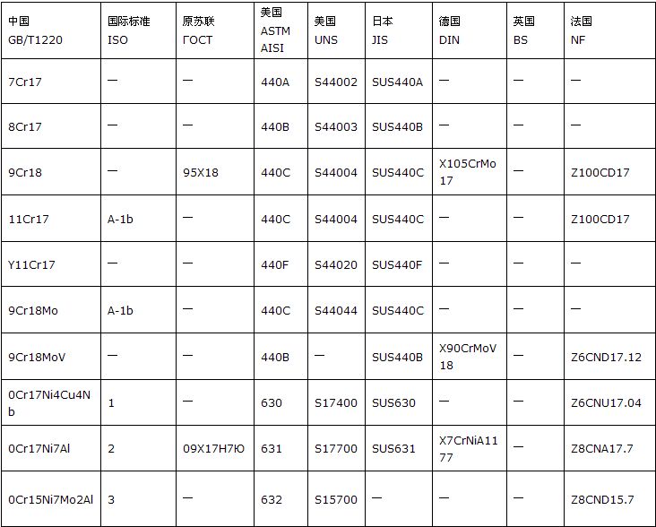

AISI440F:相当于中国Y11Cr17易切削不锈钢
5 w0 U7 X7 A1 e) \! XAISI440C:相当于中国9Cr18或11Cr17
2 Y3 ?6 O: r2 Y具体成分看http://www.0523bxg.com/ghdz.htm, J! @/ o% M& Y+ H* P% w% \8 H
